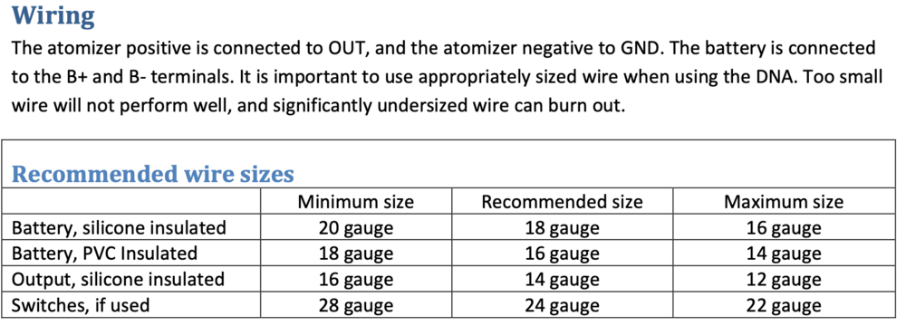

db151mod Posted September 16, 2023 Report Posted September 16, 2023 Hi guys, if in DNA 60 instead of putting the recommended 18 AWG wire I'm putting 20 AWG, has anyone tried it? Do you notice any drops in performance or heating? What have you noticed over a long period of time? And what problems might I encounter? . A thousand thanks
Wayneo Posted September 17, 2023 Report Posted September 17, 2023 20 AWG is the minimum so you're OK. Thinner wires will generate more heat. Heat is lost power. Nothing noticed over time 2
db151mod Posted September 17, 2023 Author Report Posted September 17, 2023 Quote Thinner wires will generate more heat. Heat is lost power. Nothing noticed over time Hi Wayneo, thanks for your advice, so can I feel comfortable with the 20 GA? , that I won't have power drops? A thousand thanks
Wayneo Posted September 17, 2023 Report Posted September 17, 2023 7 hours ago, db151mod said: so can I feel comfortable with the 20 GA? , that I won't have power drops? Every single item in that battery circuit can affect power drops (however you define that). You keep harping on about the MINIMUM, just use the MAXIMUM size recommended and that will be one less thing to worry about. 1
db151mod Posted September 17, 2023 Author Report Posted September 17, 2023 Quote Every single item in that battery circuit can affect power drops (however you define that). You keep harping on about the MINIMUM, just use the MAXIMUM size recommended and that will be one less thing to worry about. ok perfect, thank you very much
