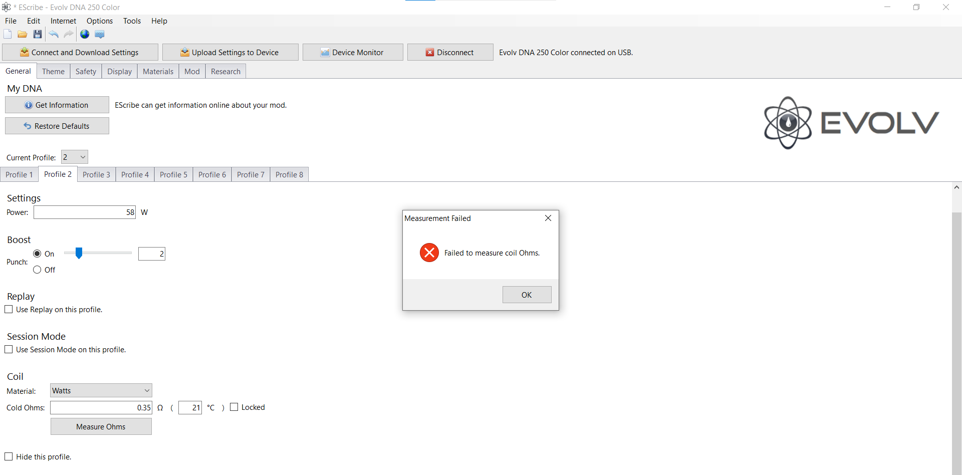

hell_storm2004 Posted July 19, 2023 Report Posted July 19, 2023 (edited) Hello Everyone, My DNA250 was working just fine till this afternoon. 30 mins later, I was getting Check Battery error constantly. So i thought my battery has run out. So i changed the batteries. And I still get the same Check Battery error. One thing i noticed the coil ohm had dropped to 0.00 ohms. My coil was a bit old, so made a new coil, put the atty in the mod, and still get the "Check Battery" error. EScribe fails to even read the coil ohms. The atty is screwed in tight. It doens't even prompt that a new coil was inserted in the mod. I updated to the latest firmware today. Still the issue persists. Can you please tell me, is my mod is toast? Or just some other issue? Any pointers would be appreciated. Edited July 19, 2023 by hell_storm2004 1

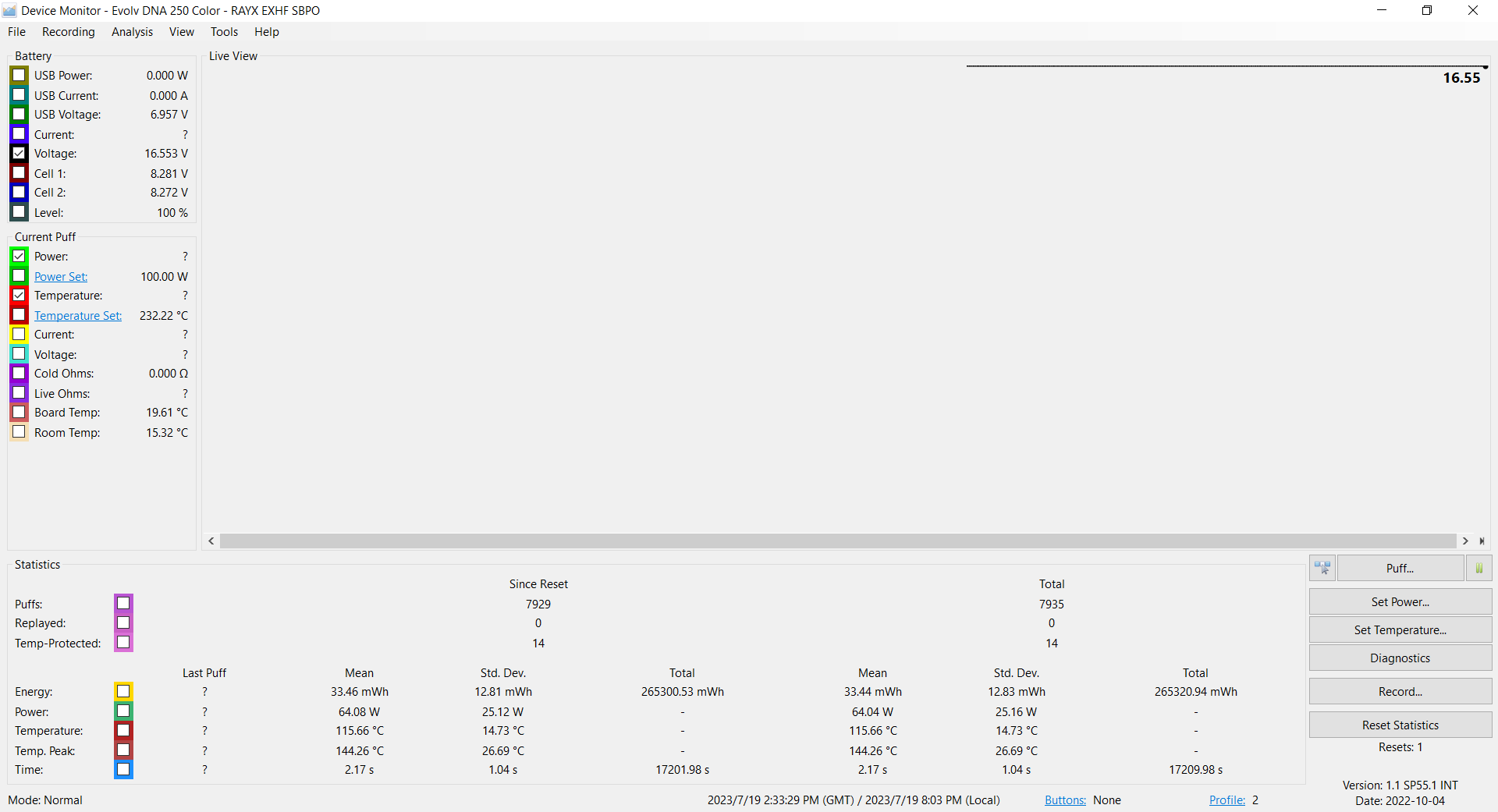

dwcraig1 Posted July 19, 2023 Report Posted July 19, 2023 Please show us a screen shot like this of Device Monitor to see the voltage of each cell.

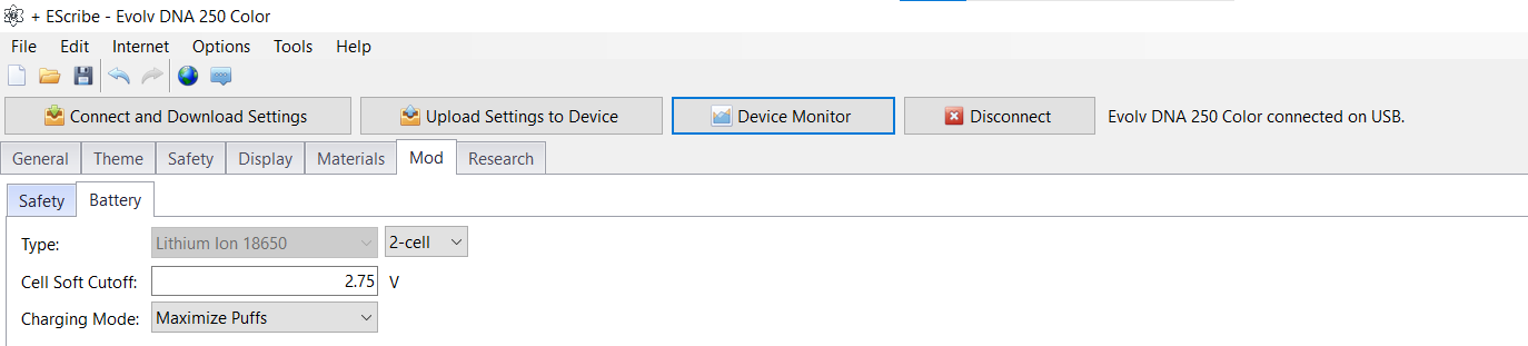

hell_storm2004 Posted July 19, 2023 Author Report Posted July 19, 2023 (edited) Here is Mod section battery information: Here is the Device Monitor section: It is a Sony VTC5. My other one is a Samsung 25R. Edited July 19, 2023 by hell_storm2004
