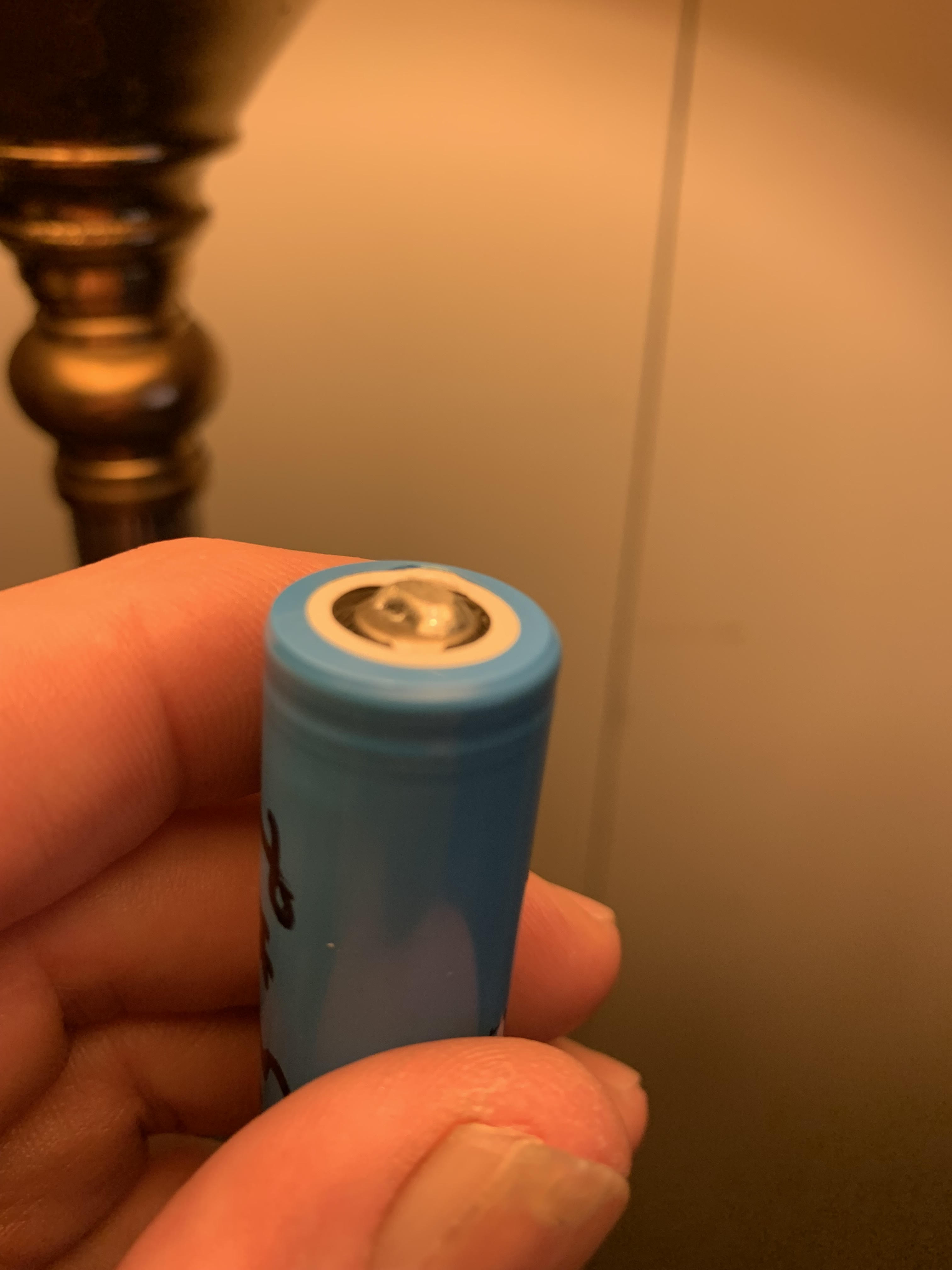

dwcraig1 Posted March 11, 2023 Report Posted March 11, 2023 I have two of them and they arrived with the same problem. The main problem is the battery isn't held in place tight enough. Using a100+ watt soldering gun I soldered a blob of silver solder to the positive end of the battery then took it down to 1.5 mm in height. This and a couple minor things fixed mine right up. Here is a link to a post I made over at ECF: https://www.e-cigarette-forum.com/threads/sxk-billet-box.898599/post-23558056 Read maybe 10 posts or so back for additional info.
