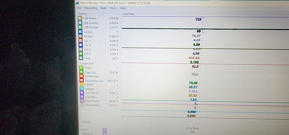

Buzzkiller Posted January 26, 2023 Report Share Posted January 26, 2023 (edited) Just built this mod, brand new Turnigy 4S lipo, initially charged to 100% but after charging again, onboard USB charger cuts off at 90%. All cells balanced at 4.0V, total voltage is at 16.3V. I can't figure it out. Edited January 26, 2023 by Buzzkiller Link to comment Share on other sites More sharing options...

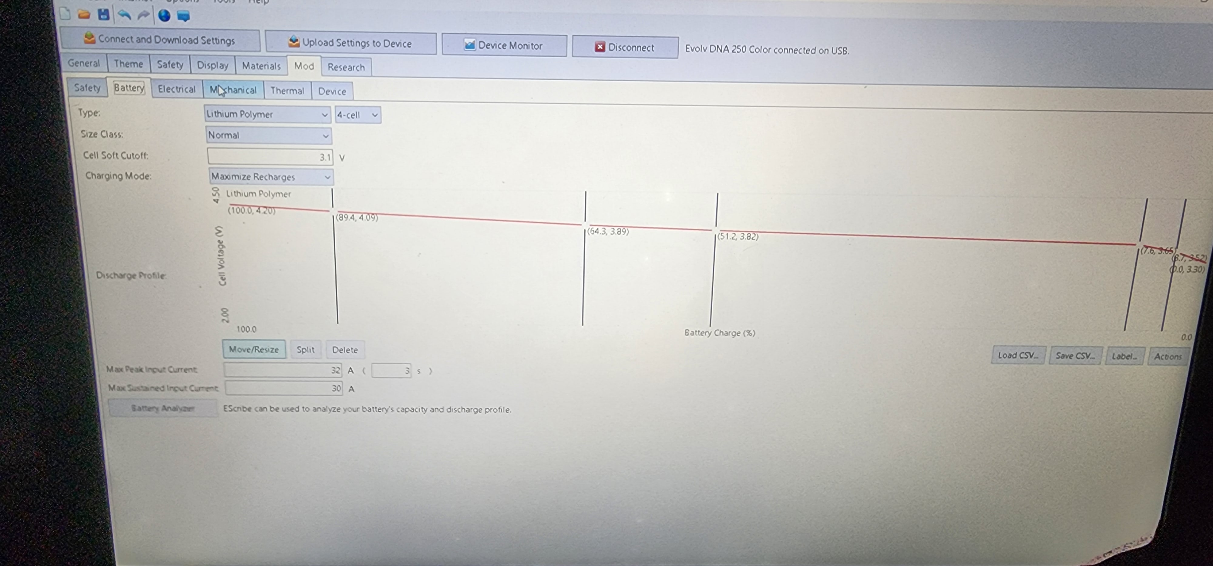

dwcraig1 Posted January 26, 2023 Report Share Posted January 26, 2023 You have it set for "maximum recharges" , that is how I set mine when using a LiPo. If you want is to charge to 4.2 volts per cell set it to :maximum puffs. Maximum recharges stops the charge at 4.1 volts. 2 Link to comment Share on other sites More sharing options...
Buzzkiller Posted January 26, 2023 Author Report Share Posted January 26, 2023 Thank you kindly, sir. What a rookie mistake...jeez. Link to comment Share on other sites More sharing options...
