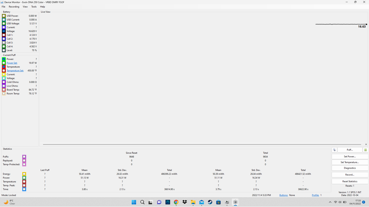

Insaneo Posted November 4, 2022 Report Posted November 4, 2022 (edited) Hi I have a DNA 250c (hammer if god DNA 400) and i recently have had issues. Every time I try and put a different battery in it keeps giving different percentages and keep saying check battery I have tried multiple batteries and all say check battery. If I do not have a atomizer screwed in it also keeps saying check battery Ive change the date and time Edited November 4, 2022 by Insaneo
Wayneo Posted November 4, 2022 Report Posted November 4, 2022 Looks like there's a problem with your wiring or board. If you look, cell 4 is showing 4.5V. What were you doing before this happened? Is it still under warranty from your place of purchase? 1
Insaneo Posted November 4, 2022 Author Report Posted November 4, 2022 (edited) Thank you Nothing just left on the side I did notice 2 days prior it was draining the battery life faster than usual. It's 5 month old I've message the company hopefully will sort Edited November 4, 2022 by Insaneo
Wayneo Posted November 4, 2022 Report Posted November 4, 2022 You can always open a Help Desk ticket with Evolv (link in my signature) line. They will guide you. I know in the past some HOGs had issues with the bottom bracket breaking (and they sold replacements), but I don't know what that's like on your version. Good luck
