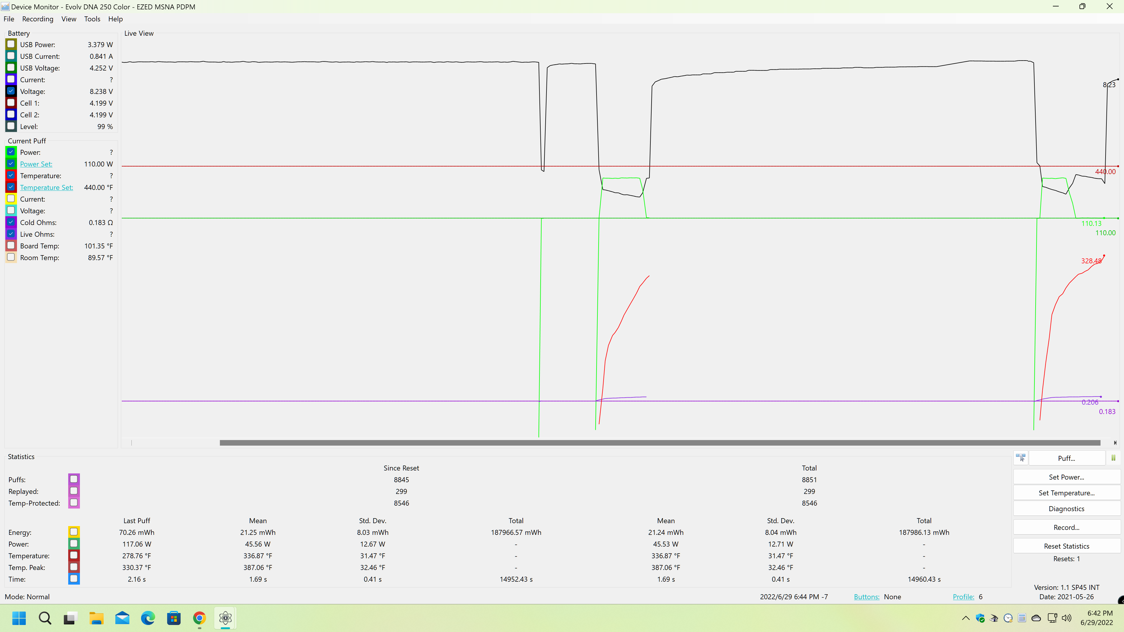

dwcraig1 Posted June 30, 2022 Report Posted June 30, 2022 Here's my 250C, first puff it's set to 2 cell LiPo, 2nd puff it's set to 2 18650s. This is in TC mode with SS316. I'm not seeing any difference in power delivery here.
