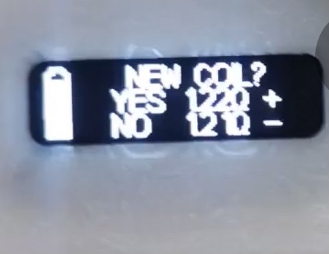

vape vape Posted March 5, 2022 Report Posted March 5, 2022 (edited) When does the NEW COIL appear as shown in this image? I have been using DNA60 for 3 years and have never seen such a setup. Edited March 5, 2022 by vape vape
Wayneo Posted March 5, 2022 Report Posted March 5, 2022 When you've had a coil where the ohms are locked and you swap it with a different coil > than the ohm lock % value. Mod -> safety tab in escribe
vape vape Posted March 6, 2022 Author Report Posted March 6, 2022 On 3/5/2022 at 4:47 PM, Wayneo said: オームがロックされているコイルがあり、それをオームロック%値とは異なるコイルと交換した場合。Mod-> escribeの安全タブ Expand What do you mean? A little more detail would be helpful.
vape vape Posted March 6, 2022 Author Report Posted March 6, 2022 (edited) I would like to reproduce it on my device but can't. Edited March 6, 2022 by vape vape
Wayneo Posted March 6, 2022 Report Posted March 6, 2022 It is an information or warning (safety) message from the mod for you, due to specific circumstances. You can hover over the field for an official definition if mine was not clear. I have already said where to find it.
