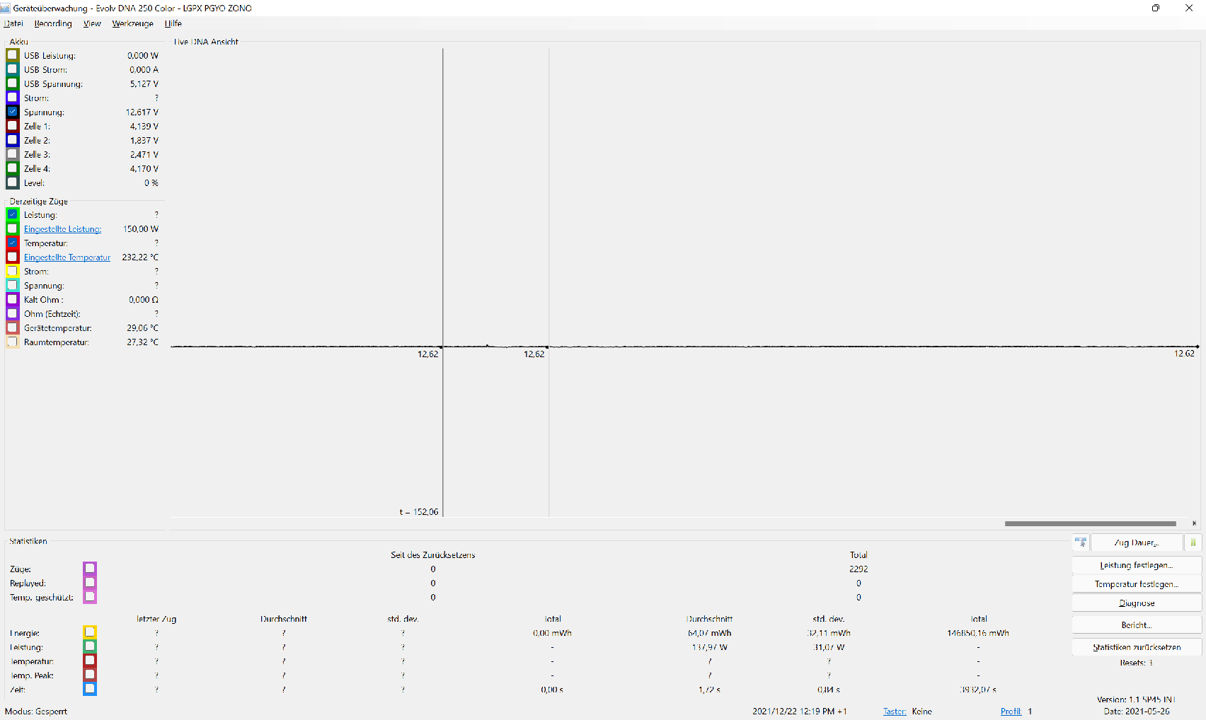

retird Posted December 22, 2021 Report Posted December 22, 2021 Can you post a screenshot like this one from Device Monitor?

Frank7814 Posted December 22, 2021 Author Report Posted December 22, 2021 I know, that Vaperz Cloud od´ffers spareparts,but i have a (wrong) battery indication 1. I have warranty of 1 year, the device i ordered July, 28th- 2. I can send it back to my online-shop. But it takes round about 2 weeks I don´t think, that it is a connector problem. Unfortunately, it´s the firt regulated mod since 3-4 years. All other Mods are full mechanical Mods Hog 3, Hog 3XL, HOG 4, Purge, etc.
