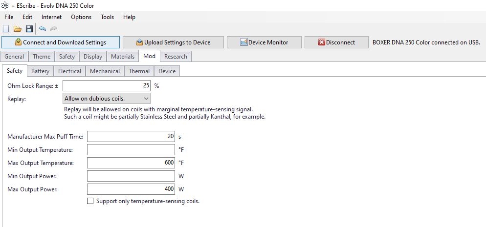

dwcraig1 Posted June 20, 2021 Report Posted June 20, 2021 I will try to help you with it. Connect your 250C to EScribe and click "Mod" tab then "Safety" tab and using the drop down menu change from "normal coils" to "dubious coils" and upload settings to device.

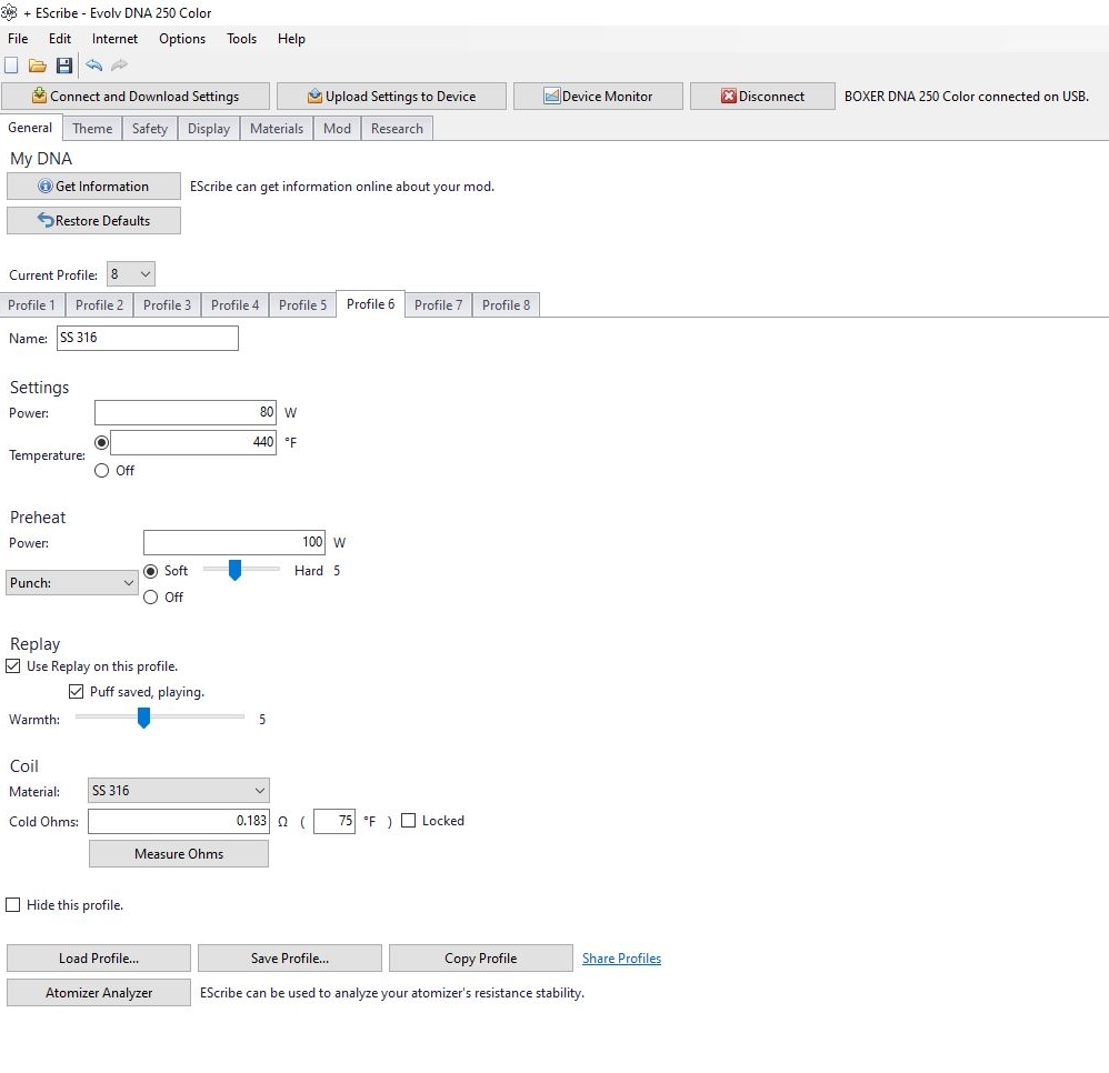

dwcraig1 Posted June 20, 2021 Report Posted June 20, 2021 Your SS316 profile should look like this except your power settings ect. will be as you want. In this profile Relpay is enabled. It is optional, your choice. Disregard the box puff playing. No need to check that. 1
Yoda Posted June 20, 2021 Author Report Posted June 20, 2021 Good lord now it works. The dubious coil change fixed it. You know I can’t thank you enough. What a burden lifted ! now that it’s working i love the replay feature. I’m so glad I purchased this dna mod. Almost every mod is good in regular watt mode but I now see the difference in DNA , even temp control works correctly now. I thought the aegis x was great in TC mode until now. Once again glad I bought this Centaurus! I have purchased cheaper mods before and this is my first really nice one. I can’t thank you enough for helping me. Now that I can run TC and replay on it I can’t put it down. Again, thank you sir and take care! 1
