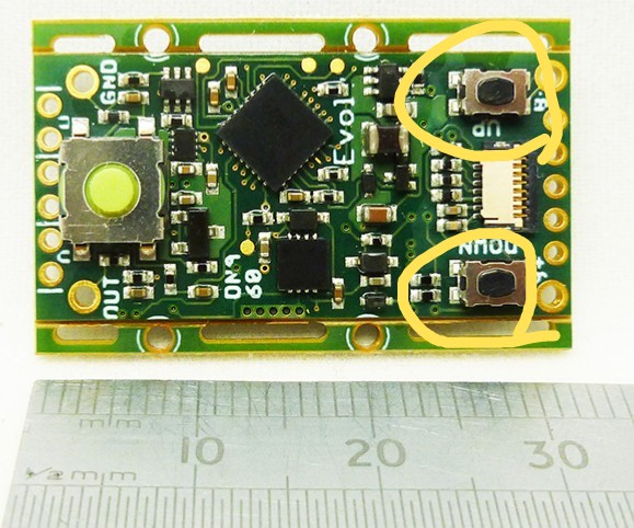

VashCorler Posted October 12, 2020 Report Posted October 12, 2020 (edited) Hi, I am an noob modder, I would like to check the name of switch button of DNA60. Not for the firw button, B3SL-1002P, but those two adjust button. I didnt find any information on internet. Is there anyone know its name? Edited October 12, 2020 by VashCorler
VashCorler Posted October 14, 2020 Author Report Posted October 14, 2020 I'm pretty sure its one of these. I've send a mail ask for technical support, hope we can get the model name of it. https://www.ckswitches.cn/products/switches/product-details/Tactile/KMR6/
VashCorler Posted October 16, 2020 Author Report Posted October 16, 2020 I just got replied by forum support, The part number of original switch is KMR641NG ULC LFS Other switch in the series should work fine as well, depend how much force you need, check out here https://www.ckswitches.cn/products/switches/product-details/Tactile/KMR6/ but remeber prefix ULC LFS have different function, you can see the explanation here. https://www.ckswitches.cn/media/1907/kmr6.pdf I guess we must use ULC LFS one. Probably alot of people already know this, but for some new beginner like me still learning this, hope the info can help someone.
