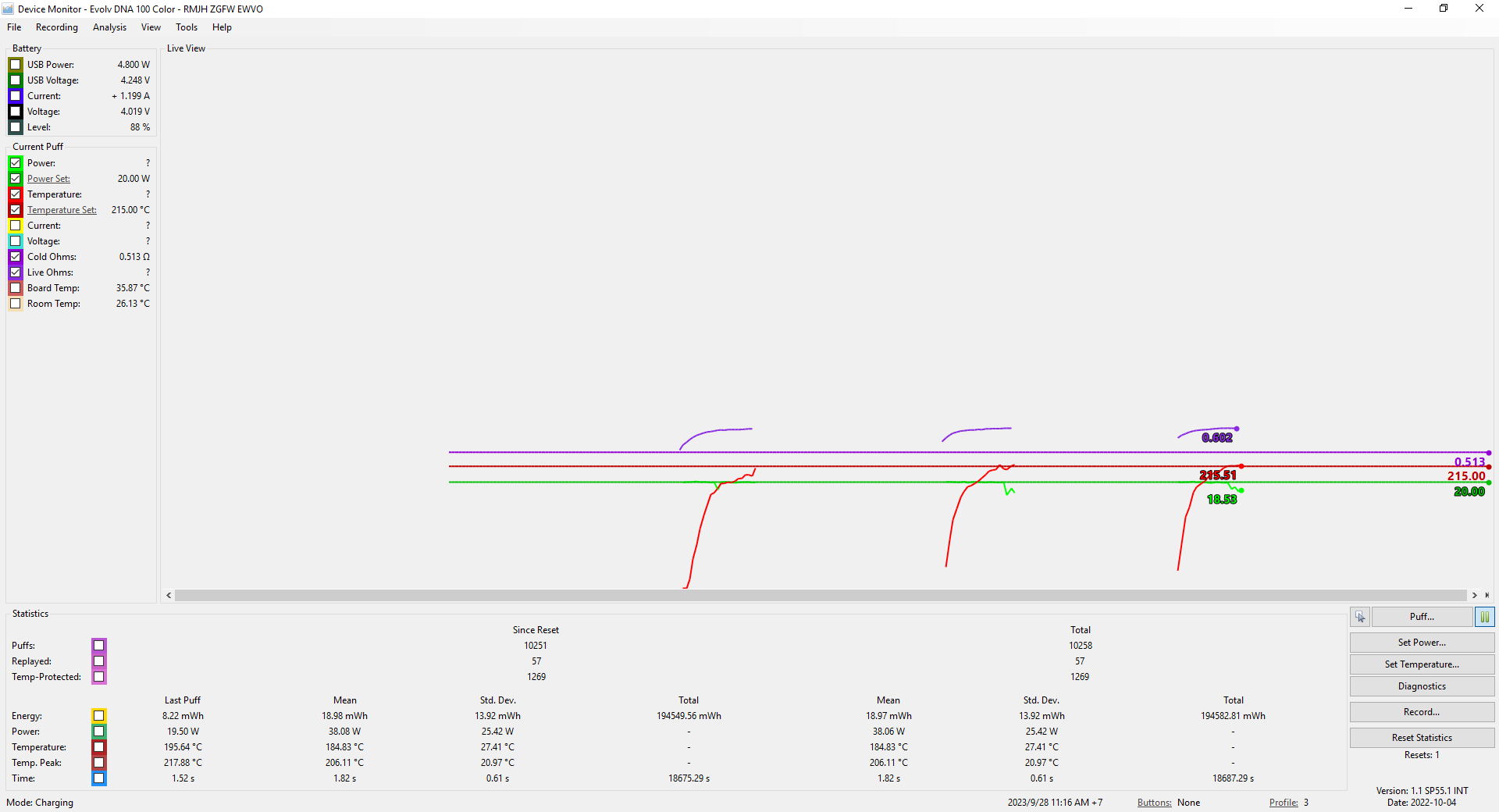

Hey, why is device monitor and onboard information shows different stats, could it that puff info just shows averages for temps and Watts? If so, is there any way for it to show max temp reached?

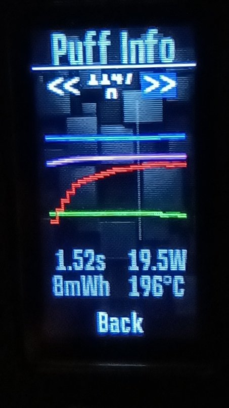

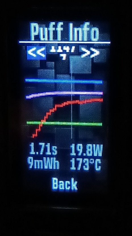

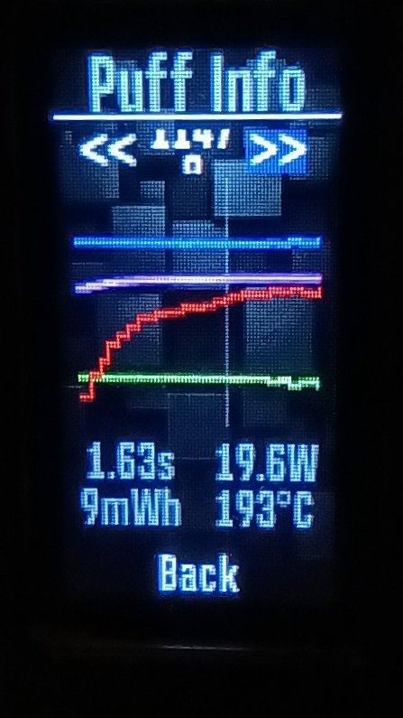

I'm also experiencing this. Does anyone have an answer yet? I'm leaving a screenshot of EScribe's Device Monitor and 3 photos I took of the on-device puff info (corresponding to the 3 data points) below.
Device Monitor says the coil hit the set temp quickly and consistently, while Puff Info shows that it didn't. If I keep firing for about 3-4 seconds or longer, Puff Info will match Device Monitor (at least in recorded temp). Also, there seems to be a thin white vertical line that appears at different positions from each puff - hope someone can tell me what it is. Thank you guys!!
