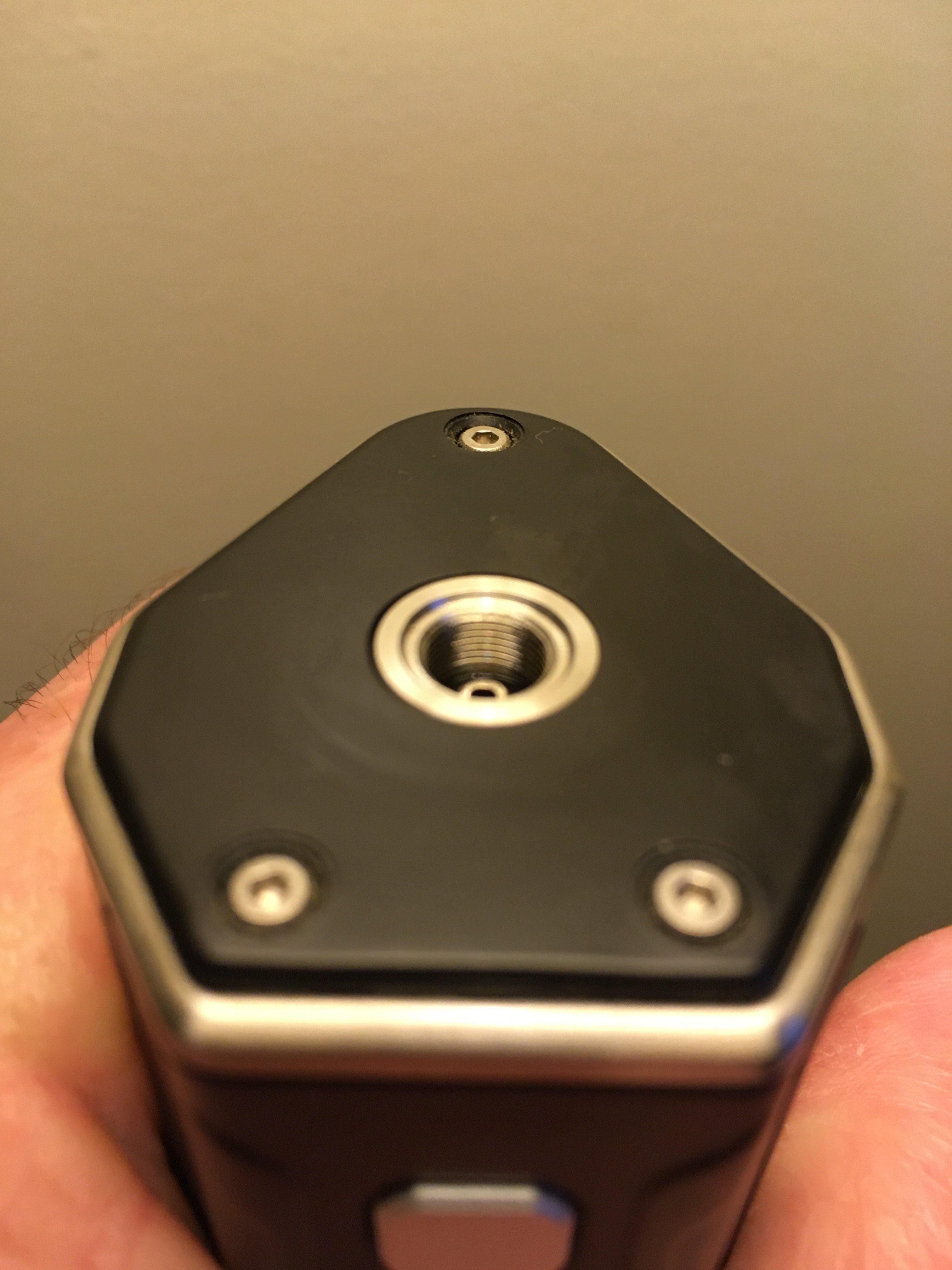

joeygregory Posted December 15, 2019 Author Report Share Posted December 15, 2019 Do you know offhand if the 5-10 is spring loaded because I'm getting no spring at all? I think it might be Jen down in there like with liquid stuck under it and mighty got sticky and got stuck I don't know if it's spring loaded or not it should be but I don't know how I could get that the pop back up without taking it apart I just read your message again and you said without taking it apart I really would not want to do that because I don't know what the hell I'm doing but I've poked on it with tweezers and other small objects very easily to try to get it to Spring or see if it's spring loaded and it's just flat no movement wonder if there's a trick for that Link to comment Share on other sites More sharing options...

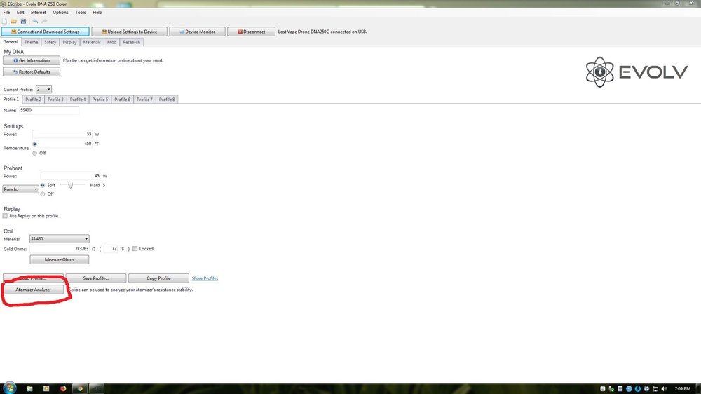

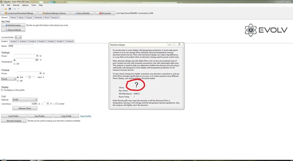

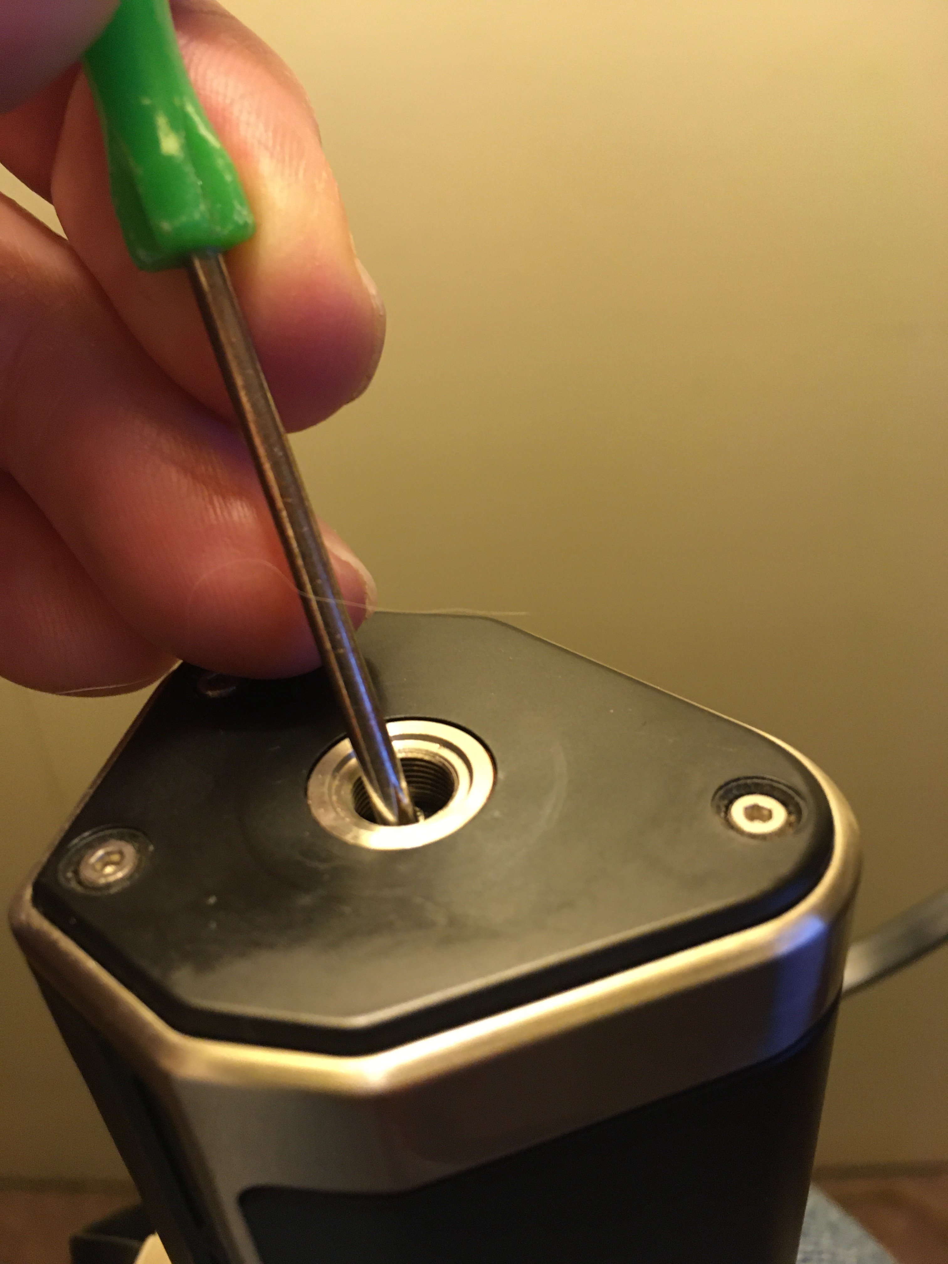

dwcraig1 Posted December 15, 2019 Report Share Posted December 15, 2019 The 510 on the Drone is spring loaded and has a fairly stiff spring. This simple test will tell you if the 510 is electrically sound: Open EScribe with mod connected to computer with data cable with no atomizer and select Atomizer Analyzer at the bottom of the General page. Atomizer Analyzer should show "?" Next use a small screw driver inserted into the 510 to short the positive pin to the ground of the 510 (threads). If you get a reading of Ohms instead of a question mark then the 510 is connected to the board. If no change then the 510 is not properly connected to the board or the board it faulty. 1 Link to comment Share on other sites More sharing options...

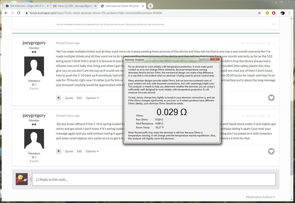

joeygregory Posted January 17, 2020 Author Report Share Posted January 17, 2020 I just got this message sorry yes I made a ticket with lost Vape themselves because the board seems to be fine it actually Fires for about an eighth of a second then reads check atomizer or something my buddy has it now he's going to clean the inside out and dry it up he said there was freaking juice everywhere inside whoever sent me the link I think it was you to check the RDA I mean the 5-10 thank you I will try to get it to him somehow so he can do it I'm not that handy with stuff like that I don't want to take it apart because I will mess it up or break something or lose something so I gave it to him because that's his bread and butter I just got this message sorry yes I made a ticket with lost vape themselves because the board seems to be fine at Ashley fires for about a eighth of a second then reads check out of my eyes ER or something my buddy has it now he's going to clean the inside out and dry it up he said there was freaking juice everywhere and side whoever sent me the link I think it was you to check the RDA appreciate that and sorry if this message Loops twice my phone's messed up Link to comment Share on other sites More sharing options...
