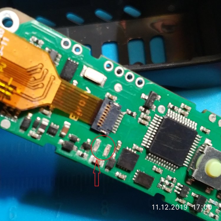

GreenDog Posted December 12, 2019 Report Posted December 12, 2019 Hi I recently bought a dna75c board and it is missing an electronic component. The screen does not turn on and the voltage ranges every 0.5 seconds approximately between 3.8V and 4.2V. Would someone be so kind as to tell me what component is missing to fix the board?. It would be faster to fix it than to wait for a resolution with the seller. I live in Spain and I bought the board in Germany. I have attached a picture. Thanks in advance.

GreenDog Posted December 12, 2019 Author Report Posted December 12, 2019 It seems to be a capacitor. I'll tell if I can solve it. Thank you very much.
GreenDog Posted December 12, 2019 Author Report Posted December 12, 2019 The answer of the technical support is that it is an inductor. The part number for this is CBC2518T101K. @dwcraig1 Thank you very much again.
