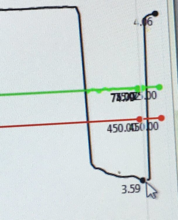

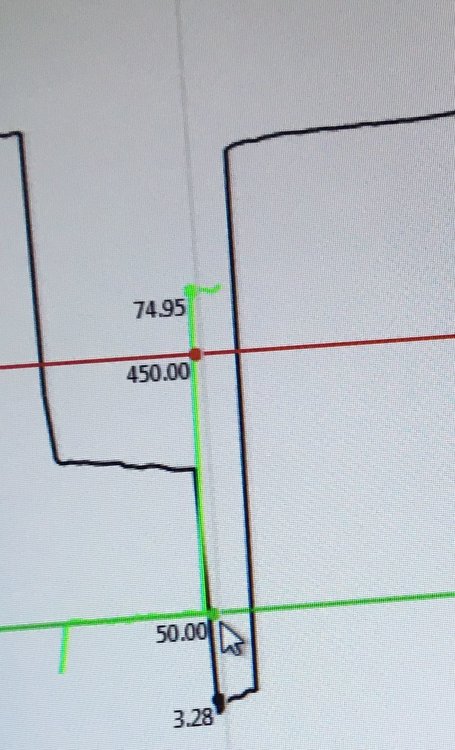

dwcraig1 Posted October 18, 2019 Report Posted October 18, 2019 Here is the difference on my VA spade before and after cleaning the battery cap with alcohol and Q-tip. That's a pretty big difference in voltage drop when firing. This is with a Samsung 21700 30T so a lesser power cell would have an even greater difference. 1
