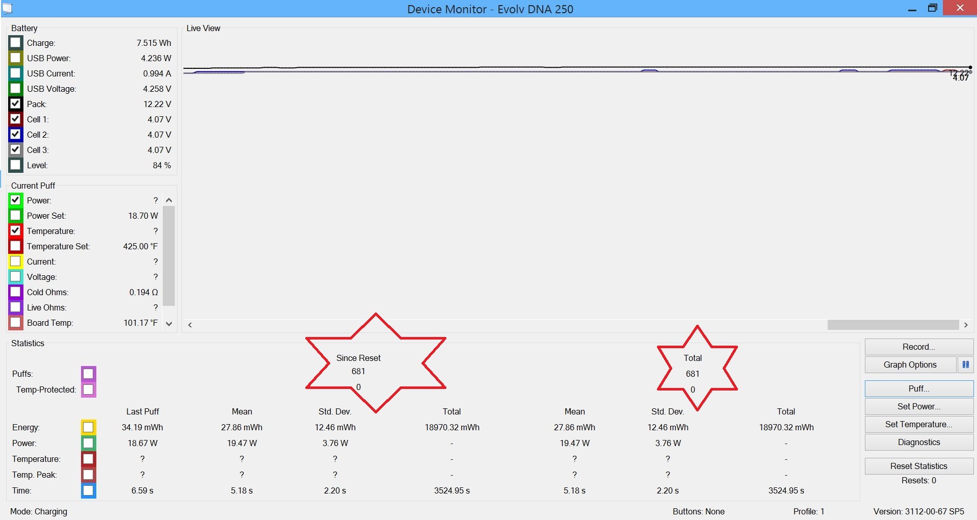

dwcraig1 Posted June 21, 2019 Report Posted June 21, 2019 Does Device Monitor in EScribe show any of the cells above 4.2 volts?

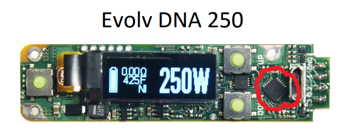

vapesmooth234 Posted June 22, 2019 Author Report Posted June 22, 2019 21 hours ago, dwcraig1 said: Does Device Monitor in EScribe show any of the cells above 4.2 volts? YES! with two Samsung pink 30Q 3000mAh 3.7Vs, it boucnes around a bit but stays at: Pack: 7.56, cell1: 2.34V Cell2: 5.22 Dual 18650 mode: I press fire get CHECK BATTERY and battery bar is empty but %100 charged on an external, barely used these cells, I press fire it says CHECK BATTERY if connected to escribe, but if i disconnect from escribe and press fire it say EVOLV DNA250 for as long as I press fire. 3 cell mode = pack = 11.78V , cell 1 = 2.34, Cell2 = 5.22, Cell3 = 4.22V I got these cells right here: https://www.ebay.com/itm/SAMSUNG-30Q-Rechargeable-Battery-High-Drain-Flat-Top-3-7V-18650-VAPE-LOT-MENU/172954891880?ssPageName=STRK%3AMEBIDX%3AIT&_trksid=p2057872.m2749.l2649 evolv DID grant me a rewarranty for this but maybe it's the cells? The other two batteries I was trying were 2 sony greens that when I put them on an external Xtar charger one says NULL and won't charge. The other seems fine. I think I tested with these Sonys before but I did also just test with the sansung 30Q pinks and got CHECK BATTERY. BTW, the Sonys have some strange markings/burnings or something shown here but people are saying there that it shouldn't be a problem but I won't be using these cells again and will recycle them now that I see it saying NULL on the Xtar: https://www.e-cigarette-forum.com/threads/what-happened-to-these-batteries.911913/
dwcraig1 Posted June 22, 2019 Report Posted June 22, 2019 When ever there is a cell with an impossible voltage reading like the one that is 5.22 volt the battery management IC has gone bad.
vapesmooth234 Posted June 22, 2019 Author Report Posted June 22, 2019 thanks craig, if you say so, I guess so . At least it didn't blow up or anything. I'll mail it back to evolve so they can take a look. I might slip my DNA75 in there too which sometimes gives me TOO HOT error for no reason and won't fire. I'm probably NOT going to buy another DNA250 board to replace this one if it comes down to it. As much as I loved this mod which is able to do dual or triple 18650 mode and is TINY for a dual 18650 mod. I think USB charging is killing the IC circuit as you said. I don't know if they'll replace the board this time (they apparently should have the first time I warranty'd it and it bricked again a couple months later). I'll link this. I just hope they care enough to try and prevent this from happening with future boards - that's why I'm going to buy a DNA250C next and hopefully the IC will never fry or anything bad happen.
vapesmooth234 Posted July 13, 2019 Author Report Posted July 13, 2019 (edited) I received my DNA250 mod back from evolve warranty and it's working great so far. It was giving CHECK BATTERY and not firing no matter what I tried. I asked them if they can tell me how it was fixed so I can post it here in case others have same issue. I said I don't think the board was replaced. They said there's no notes from the tech and said they think the board was replaced and to check the puff count. So are the red stars the total puff count? 681 seems a lot for I only ran about 10mls of juice with it since I got it back, but I just noticed I tap fire a lot even for just one hit since I don't have a power ramp or TC I tend to tap it up to temperature and may tap fire like 5 times for just one actual puff. I originally said I doubt the board was replaced , I didn't tell them because I can see the screen is still a bit dirty/blemished on the edges but maybe they kept the old screen and just replace the board? ALSO when I hit GET INFORMATION in escribe it takes me to a URL that says this: I bought the MOD January 2018. But that's still a year after the date this shows it was programmed, so that's a long time and would be an extra 1.5 year to today if it's actually a new board installed, so IOW maybe they're both from a big batch made Jan 9 2017 (if there's indeed a new board installed)? ___________________________________________ Production History Tuesday, July 2, 2019, 3:18 PM @ Hudson, Ohio, United States Mod tested A+ Battery tested (3.65V min. cell, 0.9A min. charge): 3.8V cell 1, 3.8V cell 2, 5.166V USB Firing tested (100W for 5 seconds): 97.56W Monday, January 9, 2017, 4:34 PM Board programmed Edited July 13, 2019 by vapesmooth234
