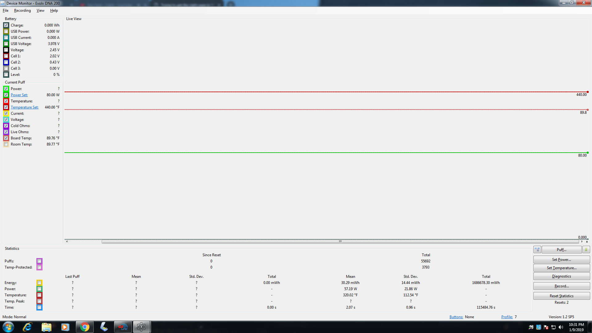

Soy Posted January 9, 2019 Report Posted January 9, 2019 (edited) whats the problem if my lavabox dna 200 have no cell 3 reading? can someone help me. it says "check battery". thanks Edited January 9, 2019 by Soy
Wayneo Posted January 9, 2019 Report Posted January 9, 2019 Can you post a Device Monitor FULL printscreen. Moderator comment: Moved to more relevant area.
Soy Posted January 9, 2019 Author Report Posted January 9, 2019 i dont know how to use escribe properly but this is the reading. i dont know why is it not charging. is it the battery?
Wayneo Posted January 9, 2019 Report Posted January 9, 2019 When was the last time you used this mod, and did anything happen beforehand? For a blown battery chip, many times that Printscreen looks differently. At the same time, 0 volts remaining in a single cell is odd. If no one has any better thoughts, you should open a ticket with the Help Desk. https://helpdesk.evolvapor.com/?a=add
