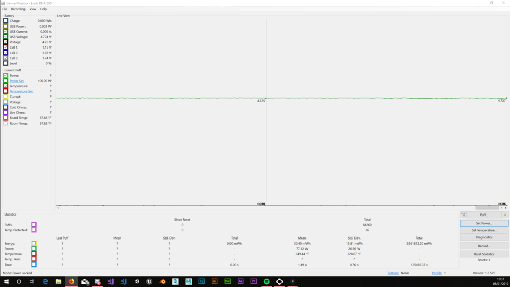

cese01 Posted January 5, 2019 Report Posted January 5, 2019 Hi vapers! Today when I tried to charge my tugboat DNA 200 I noticed that the charge icon didnt appear in the display. Connecting it to escribe I saw that it would seem not to reach Ampere. What can I do? P.S. I have already tried to perform a USB recovery charging but it is not effective, It was left uncharged for about 2 weeks
Wayneo Posted January 5, 2019 Report Posted January 5, 2019 Looking at those individual low cell voltages, your battery could now be ready for a replacement. 2
