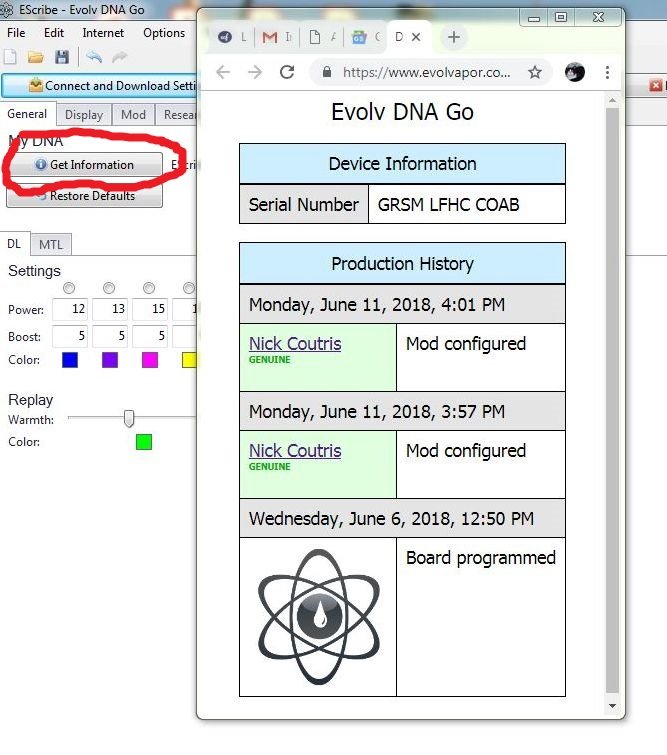

nancyemac Posted December 6, 2018 Report Share Posted December 6, 2018 hello! I see the post about DNA GO boards dying and have already requested RMA for my lost vape orion with that problem. I'm curious, how can I tell what date it was manufactured? I'm thinking about buying another one before the RMA process is complete, but don't want to buy an "old" version that will have the same problem. thanks in advance! Link to comment Share on other sites More sharing options...
dwcraig1 Posted December 7, 2018 Report Share Posted December 7, 2018 Connect your Orion to EScribe and click the "Get Information" button Board programmed date Link to comment Share on other sites More sharing options...
nancyemac Posted December 7, 2018 Author Report Share Posted December 7, 2018 thanks! this is my first mod with a DNA chipset. It died before I even tried EScribe software. Now I know. 😃 Link to comment Share on other sites More sharing options...
ArminF Posted December 9, 2018 Report Share Posted December 9, 2018 Board programmed ist the key here. As soon this is later than end of september the "bug" is fixed. Earlier dates can but not must have the issue. Link to comment Share on other sites More sharing options...
