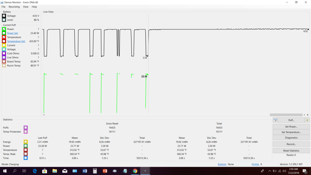

combatwombat Posted July 22, 2018 Report Posted July 22, 2018 Here is a picture of the device monitor. It is a total of 0.48 voltage drop while firing. Is this normal?
Spector NS5 RD Posted July 24, 2018 Report Posted July 24, 2018 I know my Xvostick DNA 40 uses the chassis as the Batt-GND connection to board. I would say poor connection or corrosion between board and cell.Unless Chel changed the way they wired the Xvostick's, i'm 80% sure the Batt-GND is made by relying on the 510's GND connection. What happens if you clean the battery cap threads and the brass positive pin at the bottom of the cell cavity? Don't be afraid to snug the batt cap on nice and tight. Doing all that i just mentioned, does that lessen (even a little) the voltage drop? If not, It would require opening up the mod to find the culprit.
