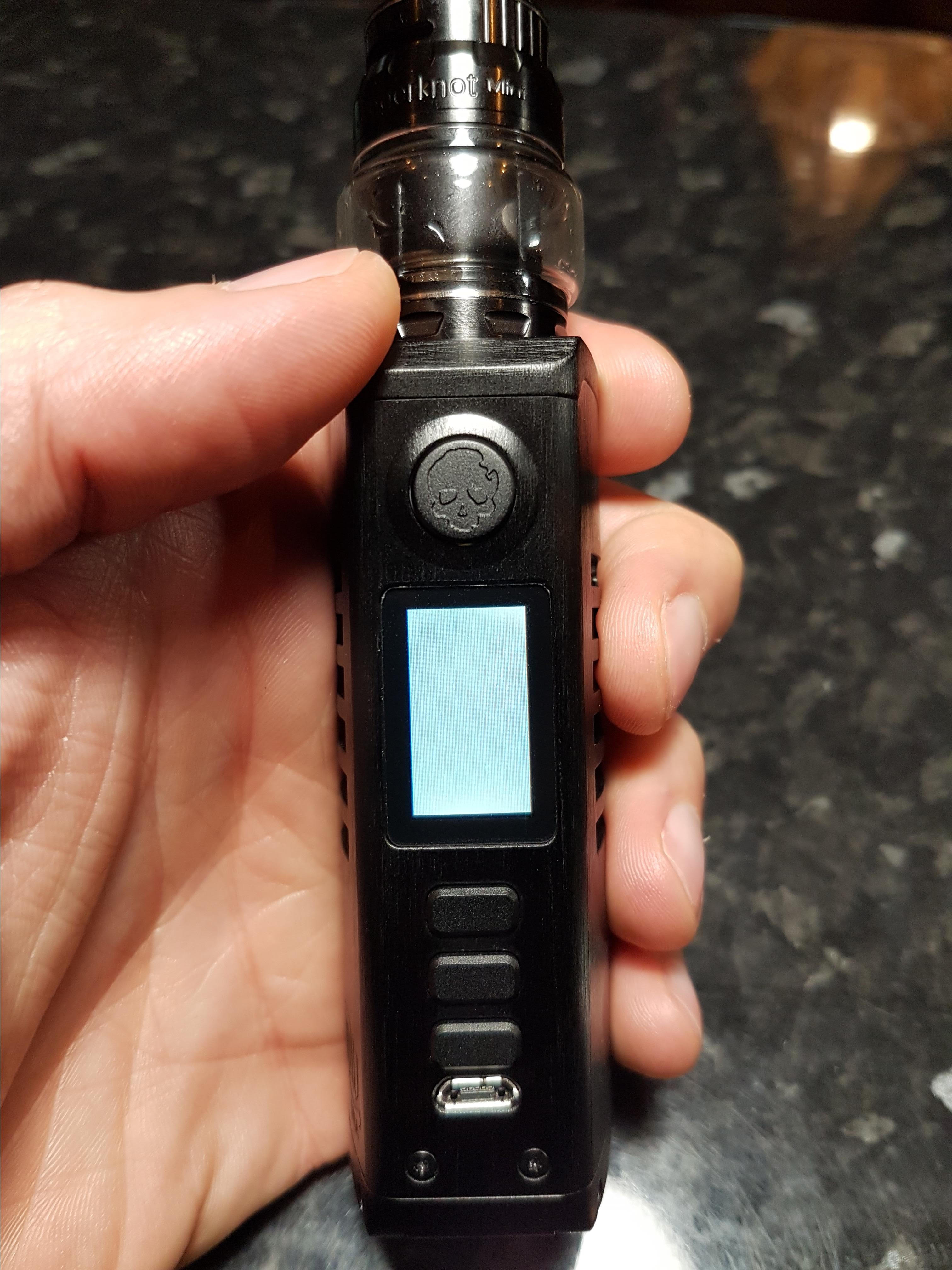

Reaper Posted May 12, 2019 Report Posted May 12, 2019 Looks like im joining the white screen club as well lol. Mine is on a dna250c and a hard reboot worked for me so far although when i unplug the screen and plug it back in its white again and i do a hard reboot and its back to normal again lol. This just started for me so idk what's going to happen next. If the screen will stay working or not.

scottua Posted June 17, 2021 Report Posted June 17, 2021 Had this issue with multiple screens on the same board. Went back to the original screen and did a "Hard Reboot with escribe and it seems to have fixed it. If this is happening to you, try the hard reboot with escribe. See if that fixes it.

steamer861 Posted June 17, 2021 Author Report Posted June 17, 2021 Try a Hard Reboot with E-Scribe, If that don't work, your screens days are probably numbered :( 1
