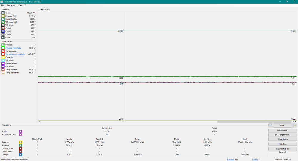

cysco0311 Posted May 16, 2018 Report Posted May 16, 2018 Hi, a few days ago during the night my e-cig (Goon 1.5 by custom vapes 528 + VTBOX 250) turned on by itself. I woke up and i noticed my e-cig was brighting: I don't know how, but the vtbox activated the resistences by itself. On the next day i plugged the box to my pc (escribe read it good) except for the LiPo battery (escribe read 0V on all 3 cells). So I have replaced it with a new Fullymax but the screen keeps on saying: "Warrenty Service". What can be the real problem? I made a factory reset using escribe, it doesn't report any error, it reads the box correctly. What can I do? Sending the box back is a bit less expensive than buying a new one, so if there's something I can do by myself, I would like to know. Many thanks and sorry for English, it's not my main language.

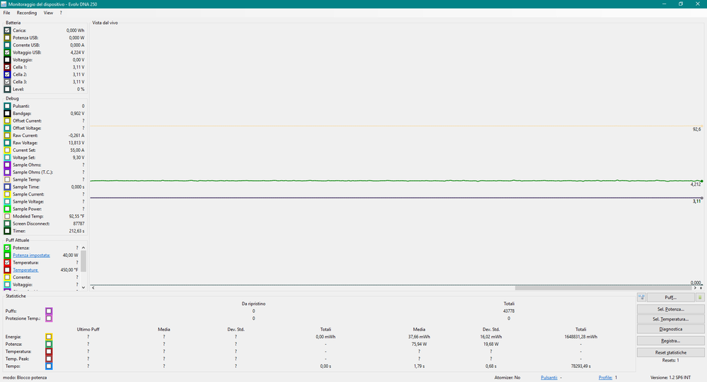

James Posted May 17, 2018 Report Posted May 17, 2018 Try left clicking seven times on the Evolv logo in Help->About of EScribe and then run Device Monitor. What does your Bandgap measurement read?

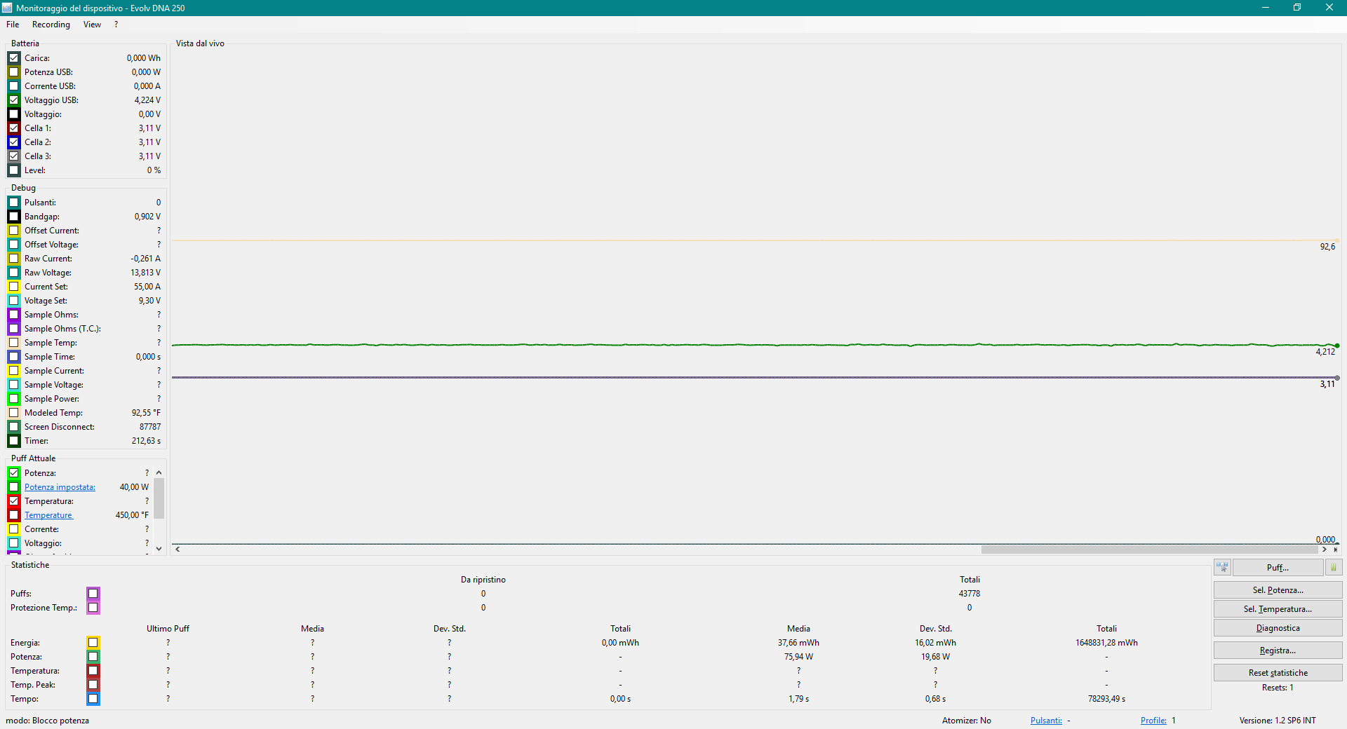

cysco0311 Posted May 17, 2018 Author Report Posted May 17, 2018 (edited) 4 ore fa, James ha scritto: Try left clicking seven times on the Evolv logo in Help->About of EScribe and then run Device Monitor. What does your Bandgap measurement read? It says: "0.901V" Edited May 17, 2018 by cysco0311
James Posted May 20, 2018 Report Posted May 20, 2018 That is low. On 1.2 SP5.1 and SP6, it should read about 1.1V. The balancer taps appear to be reading, but are you sure the power wires are correct? That number would make sense if the power wires had 3V or so on them for some strange reason.
cysco0311 Posted May 20, 2018 Author Report Posted May 20, 2018 I have been always using the wire I found in the original packaging
James Posted May 20, 2018 Report Posted May 20, 2018 I mean the power wiring of the battery input (as opposed to the balancer taps).
