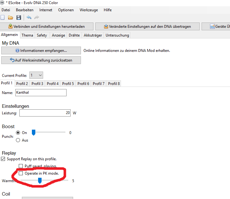

DNA Papst Posted March 31, 2018 Report Posted March 31, 2018 (edited) I am finding the following error in the current firmware: If i unscrew my atomizer which had been running in replay mode, and screw on a new one then it seems to throw out a temp protect error below the replay menu. Only way to fix this issue I have found is to take out my batteries or change into another profil. This has happened 3 times so far. i use flat clapton ss316l with 0,14 ohm . As far as EScribe goes what does the PK mode do and what exactly is it used for in Replay? Edited March 31, 2018 by soulvape

DNA Papst Posted April 3, 2018 Author Report Posted April 3, 2018 (edited) vor 18 Minuten schrieb James: Hmm. Are all of your coils of very similar resistance? Maybe it thinks you are putting the same coil back on. Thats right. And the it switch in tc Mode? And What is the pk Mode? Edited April 3, 2018 by soulvape

DNA Papst Posted April 4, 2018 Author Report Posted April 4, 2018 (edited) with your help, the error has not surfaced. Please never disable the pk mode . Only in Pk Mode Kanthal and ni80 work very goodin replay modus :-) pk mode and kanthal in replay (vape until cotton dry) in german language Edited April 4, 2018 by soulvape
