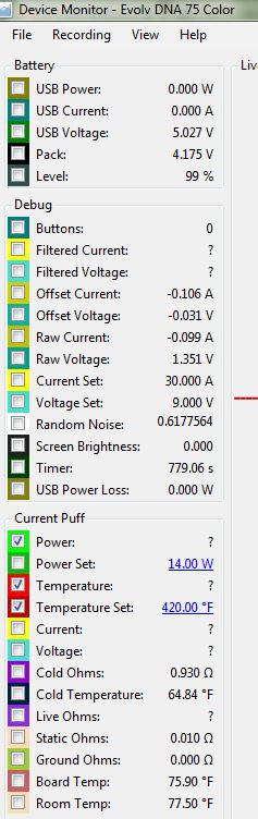

klein Posted January 24, 2018 Report Posted January 24, 2018 (edited) Just picked up a new Paranormal DNA75C and I'm not seeing individual battery cells in the device monitor. Not sure if this is a setting somewhere that i'm jut not seeing. Also, the battery is hanging on 99% and have left it charging overnight. Edited January 24, 2018 by klein
Wayneo Posted January 24, 2018 Report Posted January 24, 2018 32 minutes ago, klein said: and I'm not seeing individual battery cells in the device monitor The 75's batteries are all in a parallel configuration so presented to the board/chip as 1 cell, whether it's one or more cells.
klein Posted January 24, 2018 Author Report Posted January 24, 2018 Thanks for clearing that up. My only real reason for wanting to see this is to just monitor the balancing. Is there an easy way to do that?
Wayneo Posted January 24, 2018 Report Posted January 24, 2018 Unfortunately no, they're parallel. And IIRC in the datasheet advertised as integrated charging, and neither balance or balanced is in the entire document. Welcome
