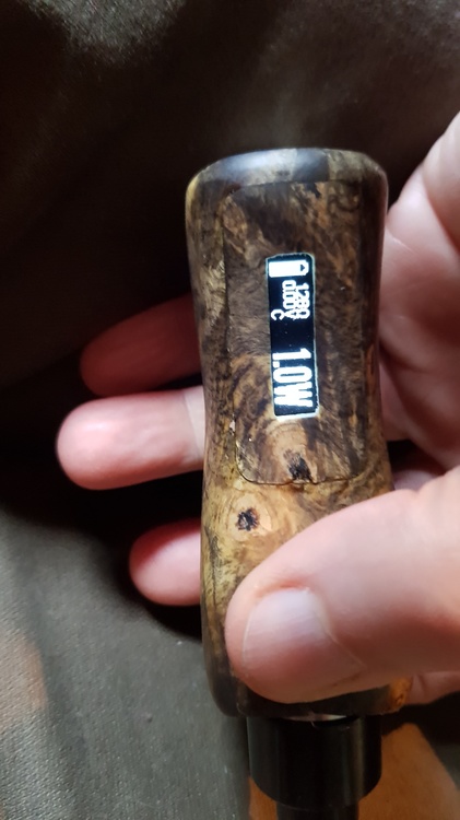

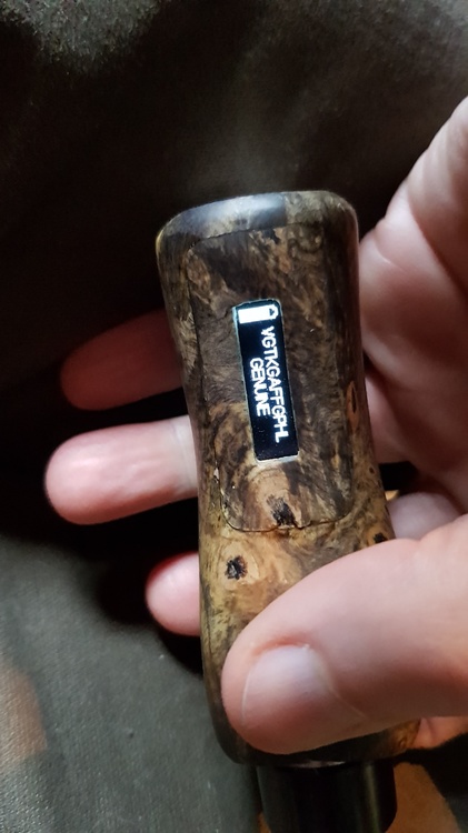

Loco modz Posted January 16, 2018 Report Posted January 16, 2018 hi all! i need some help with my dna40 device "puppet" it works nice and after a few minutes it goes to 1w and display this strange message... "vgtkgaffgphl guenine" i need to get the battery out for a few mn and restart the dna, than the same comes again... any tips guys?
dwcraig1 Posted January 16, 2018 Report Posted January 16, 2018 The message means it's genuine but you should need to press button below 1 watt on purpose, not by it's self. Perhaps your down button is sticking for what ever reason.
Spector NS5 RD Posted January 17, 2018 Report Posted January 17, 2018 I had this happen to me with my DNA 40 Xvostick. It was due to either leftover soldering flux or ejuice near or on the external button pinout on the DNA 40 board itself. I had to take the mod completely apart and clean the board with 99% iso alcohol. This solved the problem. Also, as dwcraig1 said, it could also be a stuck (stuck closed) down button.
