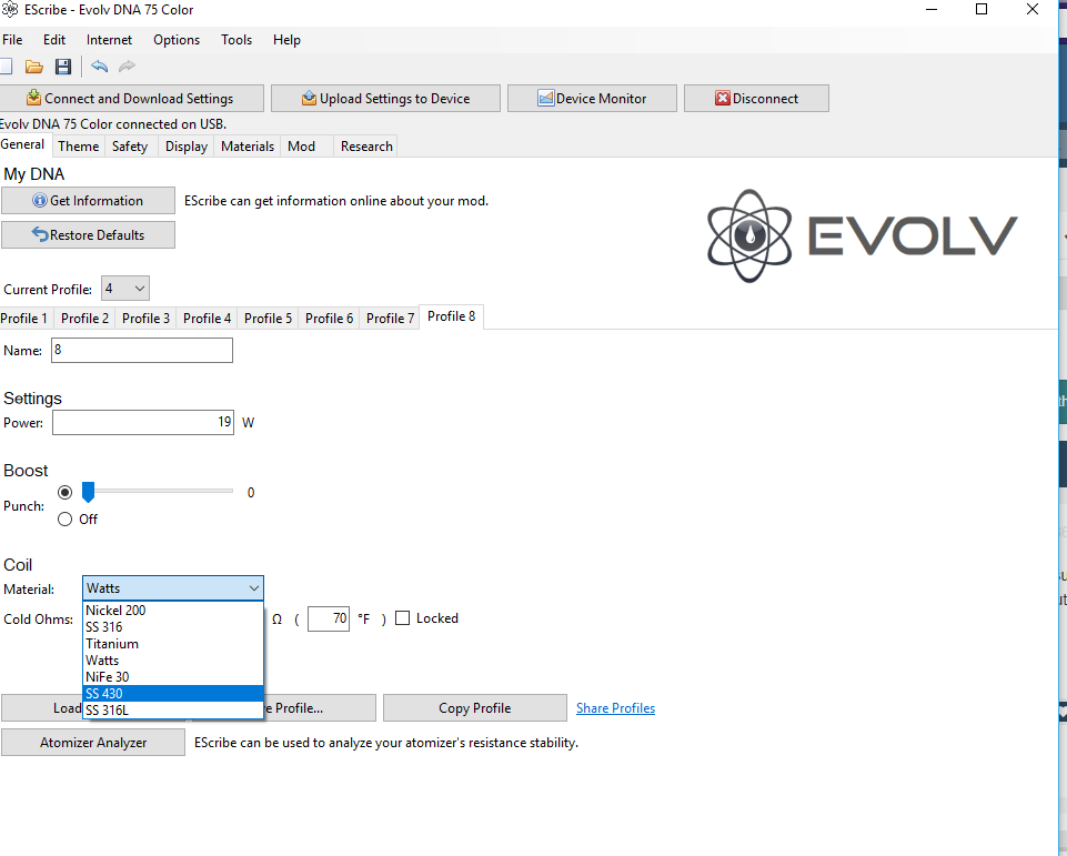

retird Posted January 4, 2018 Report Posted January 4, 2018 In eScribe select a Profile you want to change to SS430.... select SS430 in the Material list then setup the profile to the settings you want.... upload to tghe device and select that profile....in my screenshot I choose Profile 8 to change to SS430

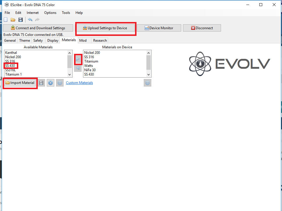

retird Posted January 4, 2018 Report Posted January 4, 2018 I've attached the csv file..... from the screenshot here you can see where to select Import Material (csv file)... Import it and it should show up in the Available Material list.. then select it there and click on the arrow I marked in red.... upload this to the device. Now you should be set to use the directions I gave earlier to create your profile and upload it...... SS 430.csv 1
