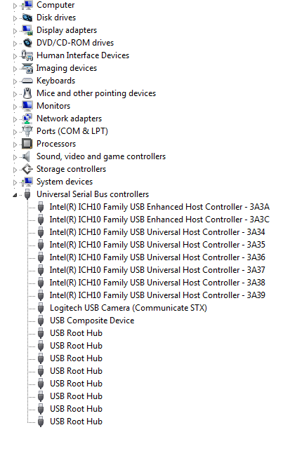

dwcraig1 Posted December 18, 2017 Report Posted December 18, 2017 In Windows Device Monitor the USB device will show when connected, in my case it listed as "USB Composite Device", if driver problem it would indicate as such. And just in case you installed a wrong version of Escribe, DNA75C requires Escribe 2 2
