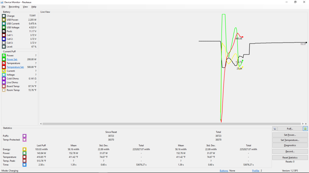

Murkie Posted November 6, 2017 Report Posted November 6, 2017 Does this information in my device monitor mean my batteries are done, there quite old. just for reference im using a reuleaux dna 200 and sony vtc4's, any help would be appreciated
retird Posted November 7, 2017 Report Posted November 7, 2017 Looks like you are firing at the upper limits of the DNA200's capabilities (your settings - 200w @0.141 ohm and 500 F). The batteries are 67% charged. What does the Device Monitor look like with batteries fully charged? What is your pre-heat settings for this build? Looks like to me that the pre-heat is working and as it drops out (don't know what your settings are?) the temp continues to rise until you hit set temp.
