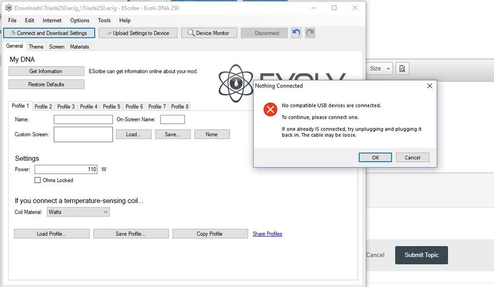

SIRERIC Posted October 26, 2017 Report Posted October 26, 2017 HI GUYS, MY triade dna 250 cant seem to connect to my windows 10... cable plugged n unplugged with a 2 cables , still the same... even reset my triade with battery removed... still the same... tried on escibe version n new as well... weird things is the cable both can charge the triade battery... but cannot connect to escribe software... pls help...... thanks
dwcraig1 Posted October 26, 2017 Report Posted October 26, 2017 There are cables that charge only. Will it connect on another computer?
SIRERIC Posted October 27, 2017 Author Report Posted October 27, 2017 Tried 3 types of different cables ... still cannot connect to my acer predator win10 laptop... have not tried other computer yet...
dwcraig1 Posted October 27, 2017 Report Posted October 27, 2017 Do you have a phone that uses the same type cable? Will it connect to your computer using one of the cables that you tried ?
jaymack58 Posted November 5, 2017 Report Posted November 5, 2017 (edited) How old is your device? I had this problem once, if i wiggled the cable just right it would connect. Could be a bad usb port on the device. Also have had issues if i had another screen from escibe open and it was already reading the device not allowing it to read again in another page Edited November 5, 2017 by jaymack58
VapingHavoc Posted November 12, 2017 Report Posted November 12, 2017 I hope you figured it out by now... I was getting the same message. Then i switched to the usb cable that came with another mod and it worked... I too am running windows 10.
SIRERIC Posted November 13, 2017 Author Report Posted November 13, 2017 YA MAN... I FOUND ANOTHER CABLE IN MY OFFICE AND TRIED.... AND IT WORKS... MEANING THE PREVIOUS THREE CABLES ARE CHARGING CABLES AND NOT ABLE TO DETECT... SO MAKE SURE ITS THE RIGHT ONES... THANKS EVERYONE 1
