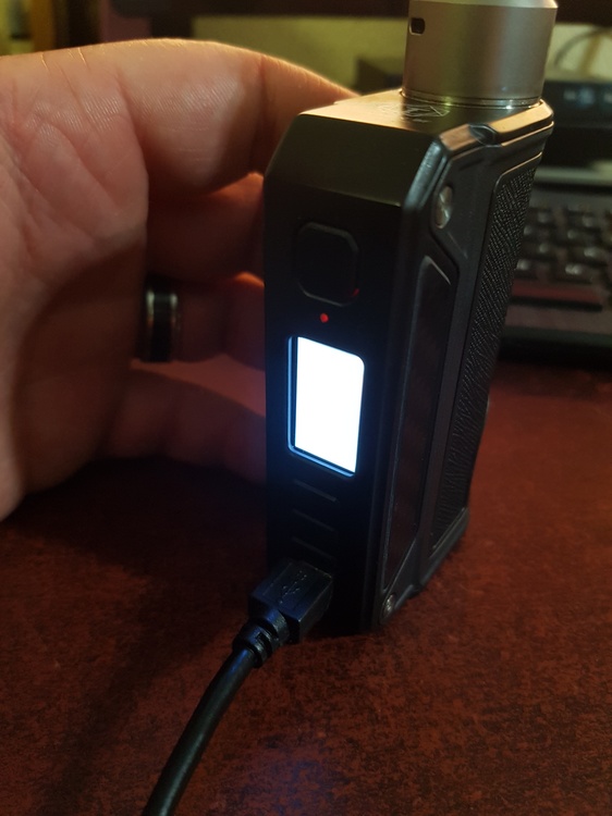

Rudi Posted September 23, 2017 Report Share Posted September 23, 2017 It worked for 2 days and all of a sudden the screen is completely white, it vapes and I can change settings in escribe but the screen only shows white. Tried factory reset, hard and soft reset, changed themes, removed battery for a while, loaded sp24 and sp25. Still the same. What could be the problem? Link to comment Share on other sites More sharing options...
Rudi Posted September 24, 2017 Author Report Share Posted September 24, 2017 After loading sp26 it was fixed last night, but this morning back to the white screen Link to comment Share on other sites More sharing options...
Spector NS5 RD Posted September 25, 2017 Report Share Posted September 25, 2017 my guess is a bad screen or intermittent screen ribbon-to-board connection. it appears you only have backlight and no pixels turning on. RMA time. 1 Link to comment Share on other sites More sharing options...
