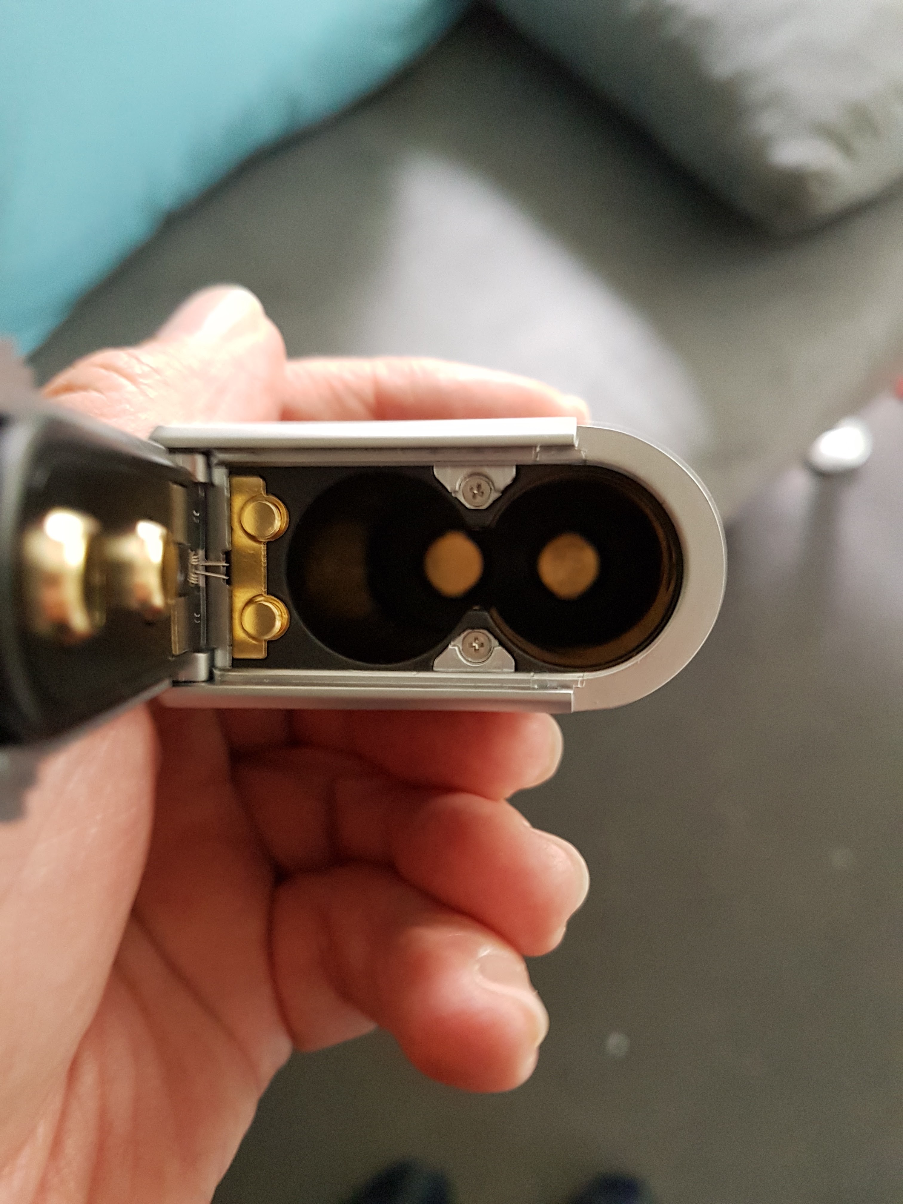

mhz0015 Posted September 7, 2017 Report Posted September 7, 2017 (edited) Hi, i have a big problem with my Akkus, the boix discarged only one akku, the other is full, every day. what can i do? In the Software patch the last Version under Akku find no changes for this problem, i need help pls. sorry for my bad english. Edited September 7, 2017 by mhz0015
Lowbytes Posted September 7, 2017 Report Posted September 7, 2017 Without disassembling no way to fix it! if your device is under warranty - send it in to let it be repaired! If not - the cells are parallel - so there´s a contact problem in the battery tray - you have to open it and look for a broken contact/soldering
Lowbytes Posted September 7, 2017 Report Posted September 7, 2017 (edited) If you have a multimeter you can try to make some measurements - set the multimeter to Ohms or diode testing - use the probes to touch both of the positive contact inside of the mod - it should give you 0 ohms - next use the probes to touch both of the negative contacts ( sitting in the flap) it may give you also 0 ohms but maybe they designed it so, that one contact goes to one of the two contact fields so do the other - the contact fields are getting shorted by closing the flap and making negative contact to the chipset - i guess one of the negativ poles is not connected to one of the contact fields ! Alternative you can try to use the mod with one cell only - i guess it will only work with cell in one slot! so it is about to find out if the problem is in the positive contact section (inside the mod) or in the negative section (in the flap) - BUT - the mod is less then a week old - send it back - bring it in - it is under warranty! My description is only for how to find out whats wrong - it is 100% Hardware related no software update can change the problem! Edited September 7, 2017 by Lowbytes
