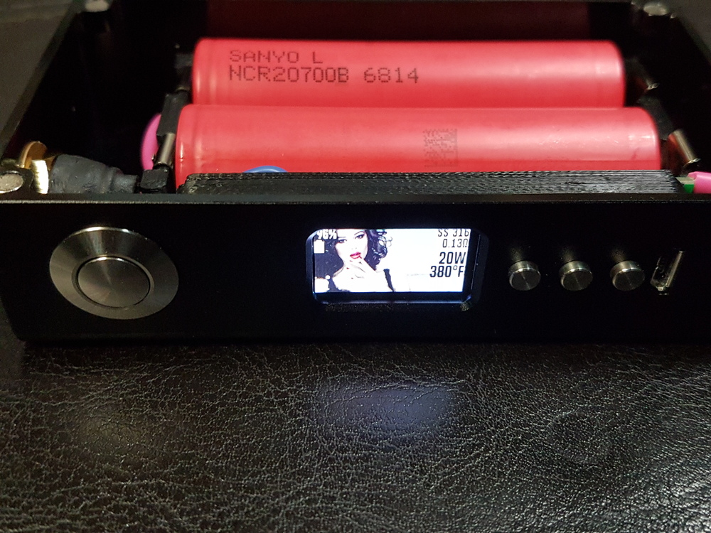

John la Posted August 13, 2017 Report Posted August 13, 2017 (edited) My new DNA 75c that i just finished building with dual sayno 20700b will not charge over 4.16v it keeps turning off the charging at 4.1657v so I decided to try the battery test for the first time and it said waiting to fully charge then started right away im guessing this is fine and that the two battery is just not that great? O and soft cell cutoff is 2.75 that's fine right? Have not used 20700 before Edited August 13, 2017 by John la
67exec Posted August 13, 2017 Report Posted August 13, 2017 Stopping charge at 4.16 Will increase cycle life substantially and impact puff count negligibly especially in a dual battery mod 1
