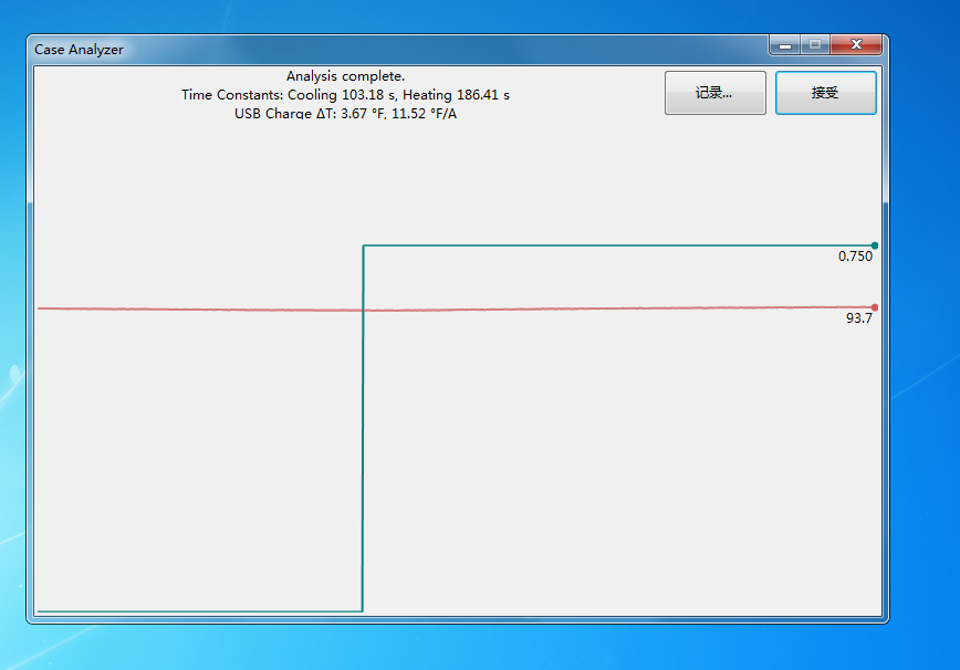

I wanted to start a separate thread to make it easier to find for others who might come looking for this specific info .
I know I'm a bit on the awkward side ( my wife told me ) when it comes to wanting the correct settings on an item I have bought , even if it doesn't make a whole lot of difference to the overall working of it . I'm also not overly happy about having to post this in Evolves forum instead of Lost Vapes but LV don't have one and Evolve seem to be gracious enough to allow this kind of chat .
I used to be good at this kinda stuff , built all my own PC's and that kinda thing but then I turned 50 and now I thank god we don't have to program VCRs anymore so I've struggled with the whole 'run case analyzer' thing myself thinking I need more than just the mod and a connection to the pc and also I was used to the likes of the Vapedroid posting the settings on their facebook page .
Anyway, enough of me taking rubbish, on to the settings :
I asked Lost Vape for the settings and they said they had to run some program and they would get beack to me . More than a week later here are the settings they sent me . Maybe some more in the know might have a look over them and comment and hopefully this thread might help other lost souls like myself .
  • 2 weeks later...
Posted
Case Analyzer (at least prior to the newest SP, which I'm testing) does not populate the Case USB Connect Temp Rise field.  I haven't gotten my LV mod yet, but on the VapeDroid and on two BAR mods (stab wood) DNA 75c mods that field is around 2°F.
Currently, the best way to set these (assuming CA still isn't working right) is to first put on or create a theme that shows you the room temperature.  Let the mod set for 2+ hours in a place you KNOW the temperature (use two thermometers or something and average).  The difference between what the mod room temp reports and the actual room temp should be placed in the Case Static Temperature Rise.  That's the most important field of all because it's how the mod determines ambient when it's just sitting.
Then hook up the mod to escribe and use the diagnostic disable usb charging feature in device manager.  Let it sit for a good hour, again in a place you know the temperature of.  The difference between room temperature and the mods reported room temperature should be placed in the Case USB Connect Temp rise field.  Upon setting that field the ambient temperature reading will be right both when the mod is just sitting and when it's connect to computer but fully charged.
The rest of the settings only matter when you're hooked to a charging source and actually charging.  Evolve is incorrectly assuming you are charging at 0.750A and everything they do here is wrong.  It's also hard to determine these values manually, so you're probably best off not resampling while you are actually charging.
