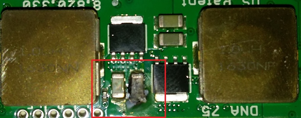

I have seen this a few times before, sounds like one of the capacitors near the the thermistor (board temp sensor) has shorted. This is typically caused by ejuice soaking the board. DNA boards are coated to withstand liquids, but it is not 100% invulnerable.

Yes, I am not a fan of the way you need to take the 510 out to take the therions apart. its a T-5 torx in case you need that info. and again, yes, they are surface mount parts, and it requires a board replacement. I have also attached a picture of a worst case scenario short on a board.

Well, I just changed the board and you were right on the money. Kind of amazing managing to diagnose it over the internet based only on a description. See attached, dead board on top.
Exactly like the one you posted a photo of. I replaced it and now its working as it should. So thanks a TON for your help. Your advice regarding taking the Therion apart was also very useful. All in only took 30-40 min start to finish. At this point I am not far off what I would have spent on a new one, but I suppose I do have a spare DNA screen now, and if I am totally honest I rather enjoyed fixing it.

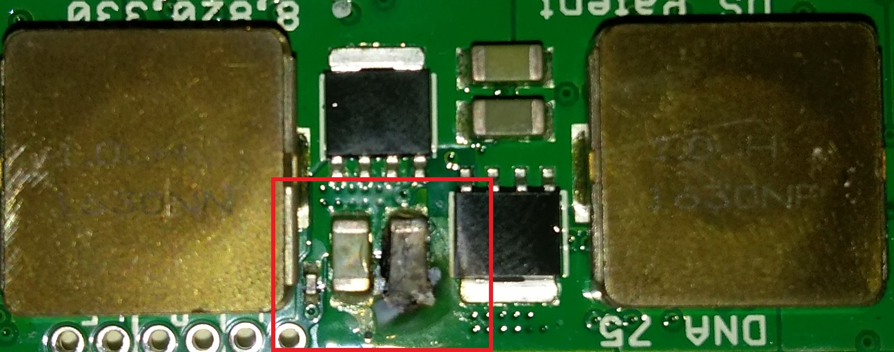

Box works but it drains batteries even in sleep. 8am to 12.30pm, from 99% to 0. Not being used.
Here the situation.
Do u think I am going to fix it changing only the resistor like or will i need toc change also the capacitor?
Can not find any information about those components :(
