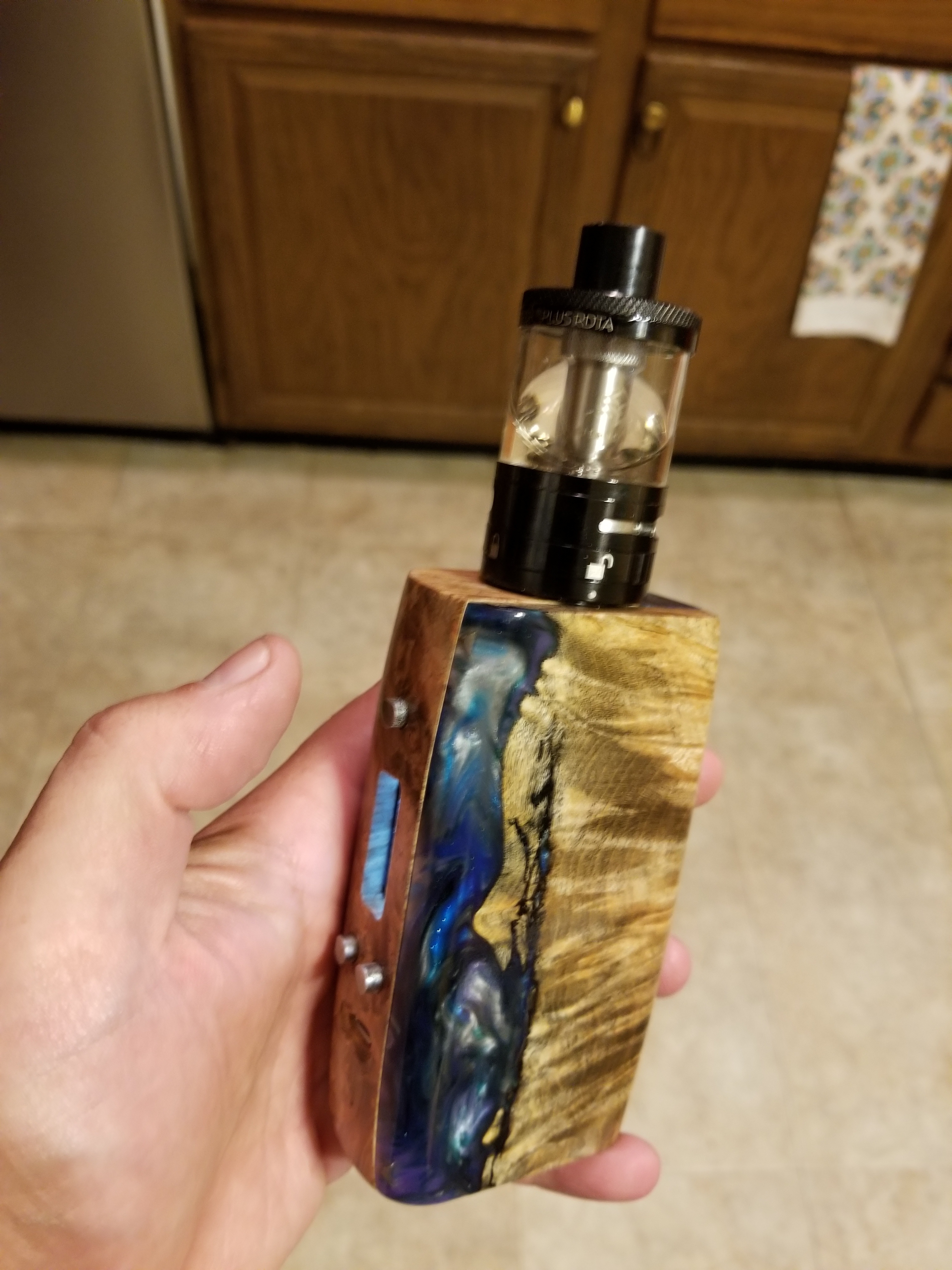

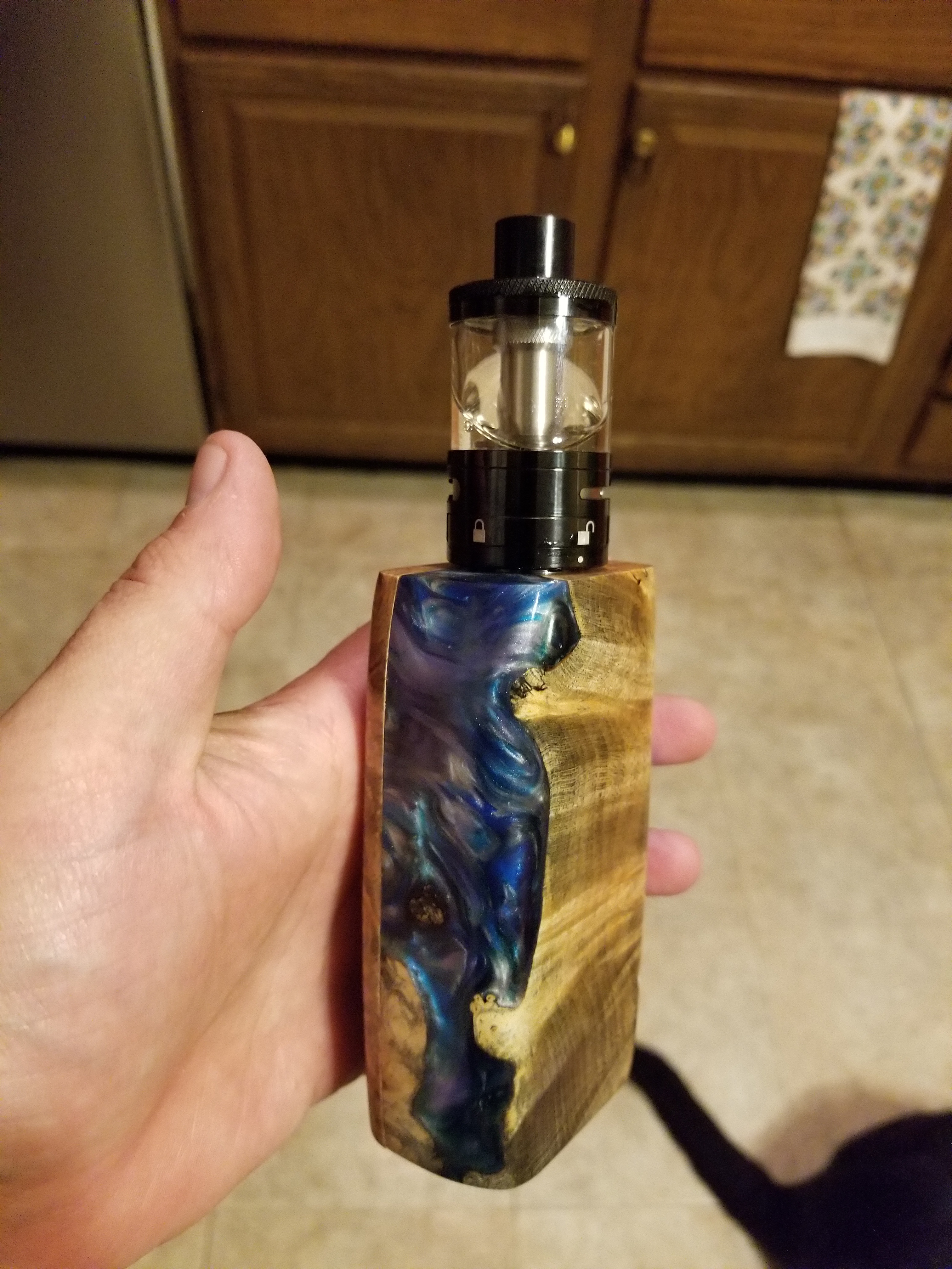

everpresentnoob Posted July 23, 2017 Author Report Posted July 23, 2017 Got my board back from Evolv. got it put in a stabwood box I made on my drill press with End Mill bits. Im happy with it. should have done a few things differently during the carving, but now I know for the next one. 1
