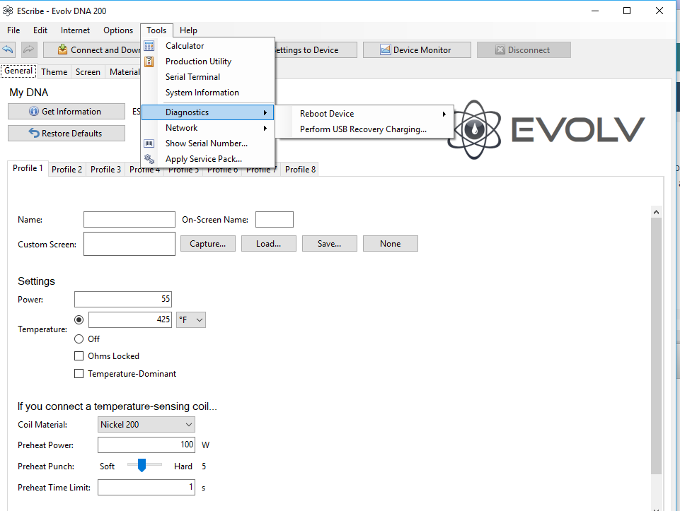

retird Posted June 10, 2017 Report Share Posted June 10, 2017 What are the voltage readings for each cell as shown in Device Monitor? What is the "Pack voltage? USB Recovery: Goto Options/User Interface and select Manufacturing, close Escribe and then start it again, then go to Diagnostics: Link to comment Share on other sites More sharing options...
Vercanti Posted June 10, 2017 Author Report Share Posted June 10, 2017 6 hours ago, retird said: What are the voltage readings for each cell as shown in Device Monitor? What is the "Pack voltage? USB Recovery: Goto Options/User Interface and select Manufacturing, close Escribe and then start it again, then go to Diagnostics: For some reason cell 2 was reading as 0 and cells 1 & 2 were reading just above 2. The pack Voltage was reading 4.086? Link to comment Share on other sites More sharing options...
