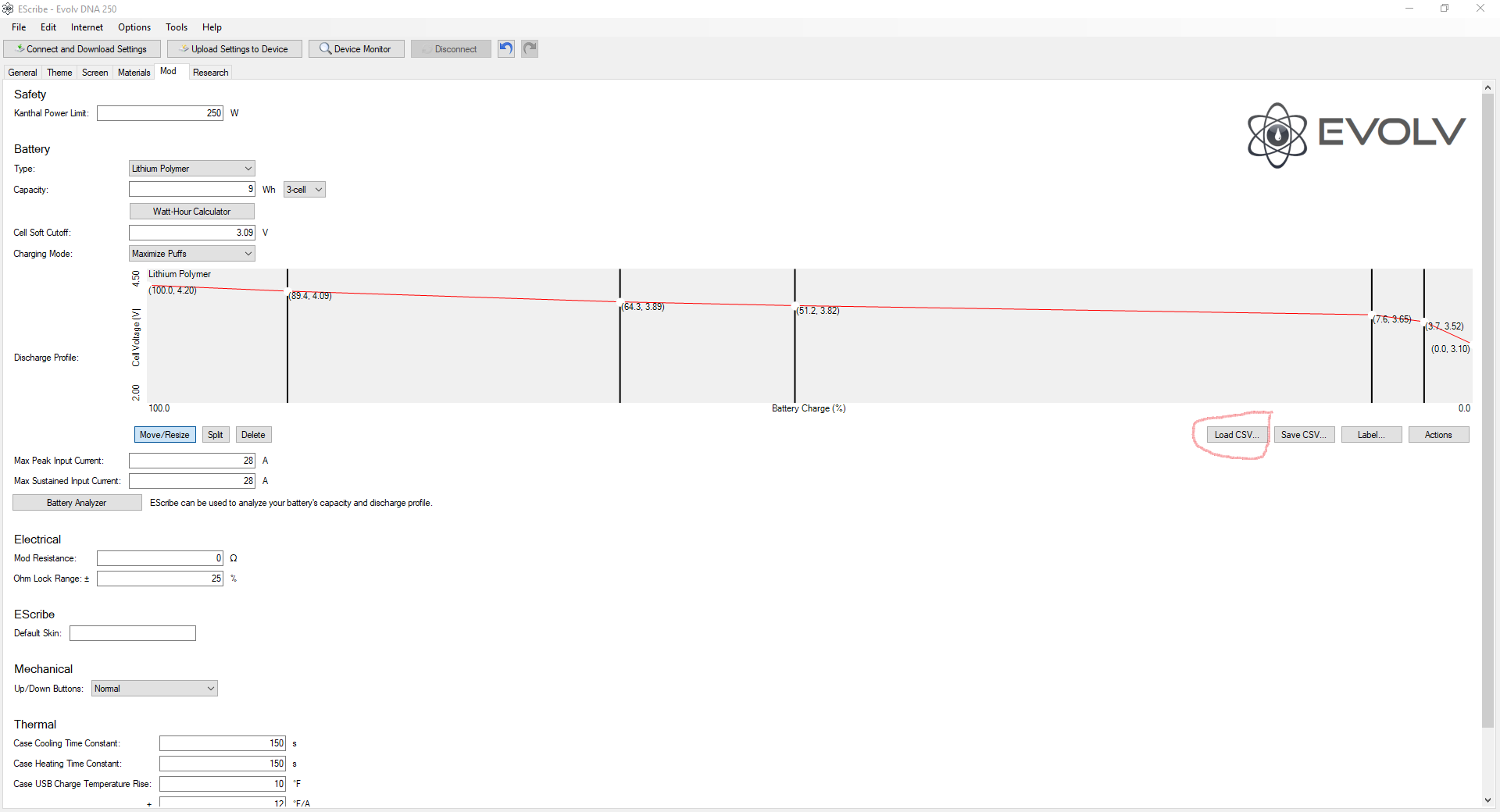

giz_60 Posted June 5, 2017 Report Posted June 5, 2017 You try loading this .csv file for your batteries in the 'Mod' tab & set your Wh to 28.3....LG_HG2 (3)_18650_3000 mah_28.3 Wh.csv 1
Visara Posted June 5, 2017 Author Report Posted June 5, 2017 Where is the place where I change the Wh to 28.3? I got the CSV file loaded, but can't find the Wh part
Visara Posted June 5, 2017 Author Report Posted June 5, 2017 It seems to be correct now. Thank you SO much. This was really bothering me for the last month or so and you fixed it for me in just a few minutes. I appreciate it big time!
