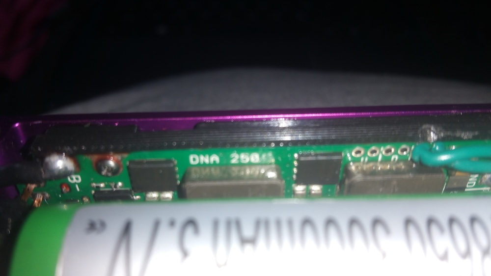

Chris5410 Posted May 26, 2017 Report Posted May 26, 2017 Okay so I have a DNA 250 chip in a box that was already built as a dna200. It came with a 3-cell lipo that I have now taken out and replaced it with a dual 18650 sled. My problem is that with dual 18650s it should be capable of 167 Watts right? However I'm getting a Max of 133 Watts. What am I doing wrong?

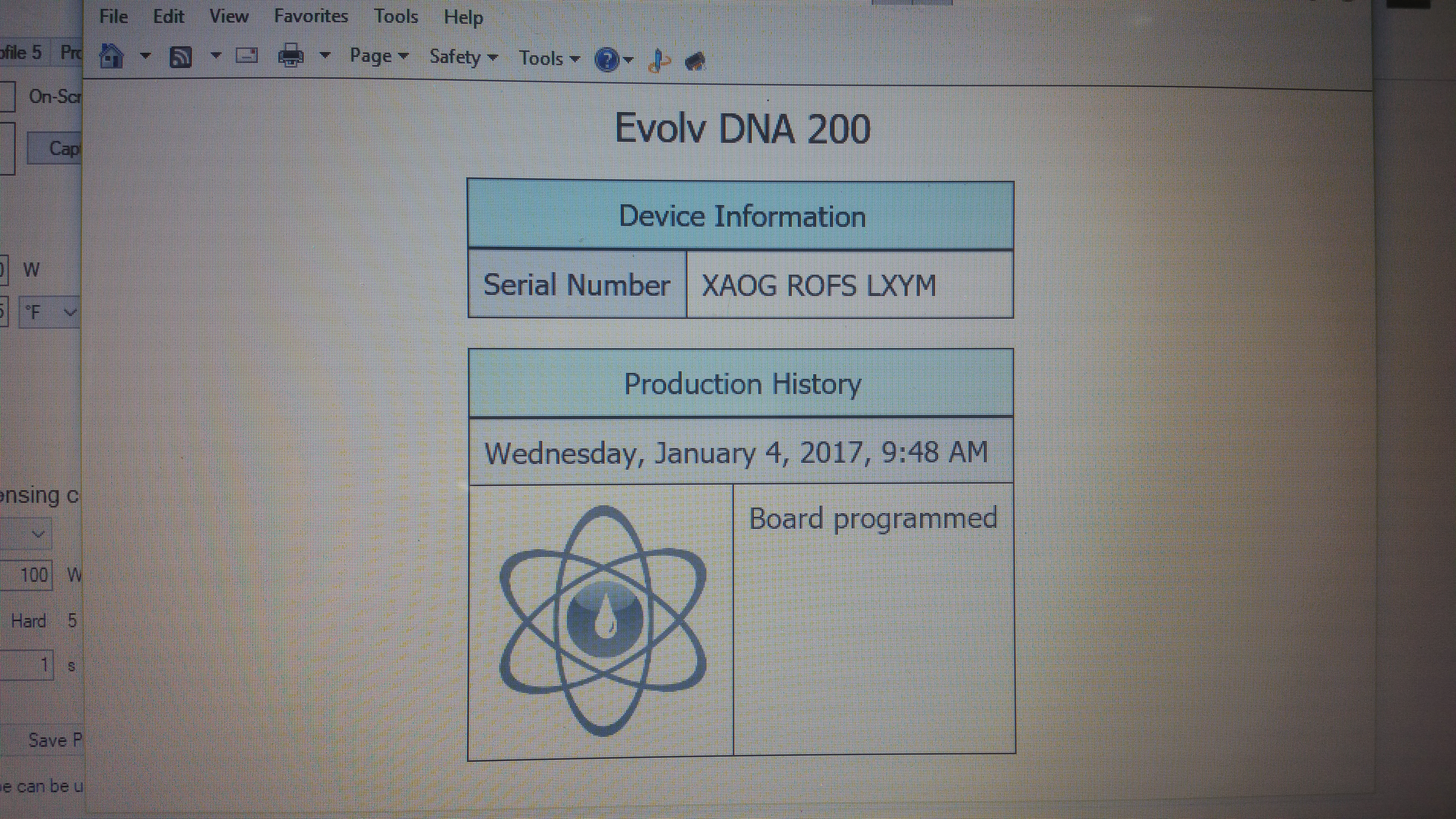

retird Posted May 26, 2017 Report Posted May 26, 2017 What do you see when you click on "Get Information" under the My DNA section of the General Tab? Post a screenshot of what you see.... thx

Chris5410 Posted May 26, 2017 Author Report Posted May 26, 2017 But according to the board it is a dna250
retird Posted May 26, 2017 Report Posted May 26, 2017 I imagine you purchased the box as a DNA200 device and the board was programmed as a DNA 200 on January 4, 2017 thus a 2-cell configuration would be 133 watts...
Chris5410 Posted May 26, 2017 Author Report Posted May 26, 2017 Yes it was purchased as a dna200. Is there any way to reprogram it as a dna250?
retird Posted May 26, 2017 Report Posted May 26, 2017 None that I know of......that programming is done at Evolv as far as I understand it.....
