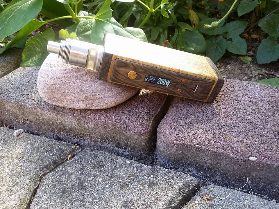

styks Posted July 7, 2015 Author Report Posted July 7, 2015 Hi all, I'm new to the forum,Just ordered my Evolv DNA 200 , a 1300mah LiPo and some XT30 connectors.I'm hoping to be able to build this in a wooden box as I've already done with a SX350J board. I made sure the board is well vented as wood is a decent heat insulator.Just wondering if there might be any issues with this board regarding NOT grounding to the case? Shielding etc. ...... The SX350J works fine but thought I better ask first.
John Posted July 7, 2015 Report Posted July 7, 2015 You will be fine. We have run these in plenty of nonmetallic enclosures, as well as without any enclosure at all. Do make sure you run the case analyzer, though, as your mod's thermal properties will not match the aluminum reference design.
styks Posted July 7, 2015 Author Report Posted July 7, 2015 Thanks for the swift response John.Ok, great stuff, will do.
Wick Posted July 10, 2015 Report Posted July 10, 2015 John said: You will be fine. We have run these in plenty of nonmetallic enclosures, as well as without any enclosure at all. Do make sure you run the case analyzer, though, as your mod's thermal properties will not match the aluminum reference design. Expand LOL... I'm running the invisible enclosure myself
Ralf Posted August 1, 2015 Report Posted August 1, 2015 in der Box steckt Ein SLS xtron Lipo Akku 1000mAh 3S1P Box ist groà 27x57x110mm
