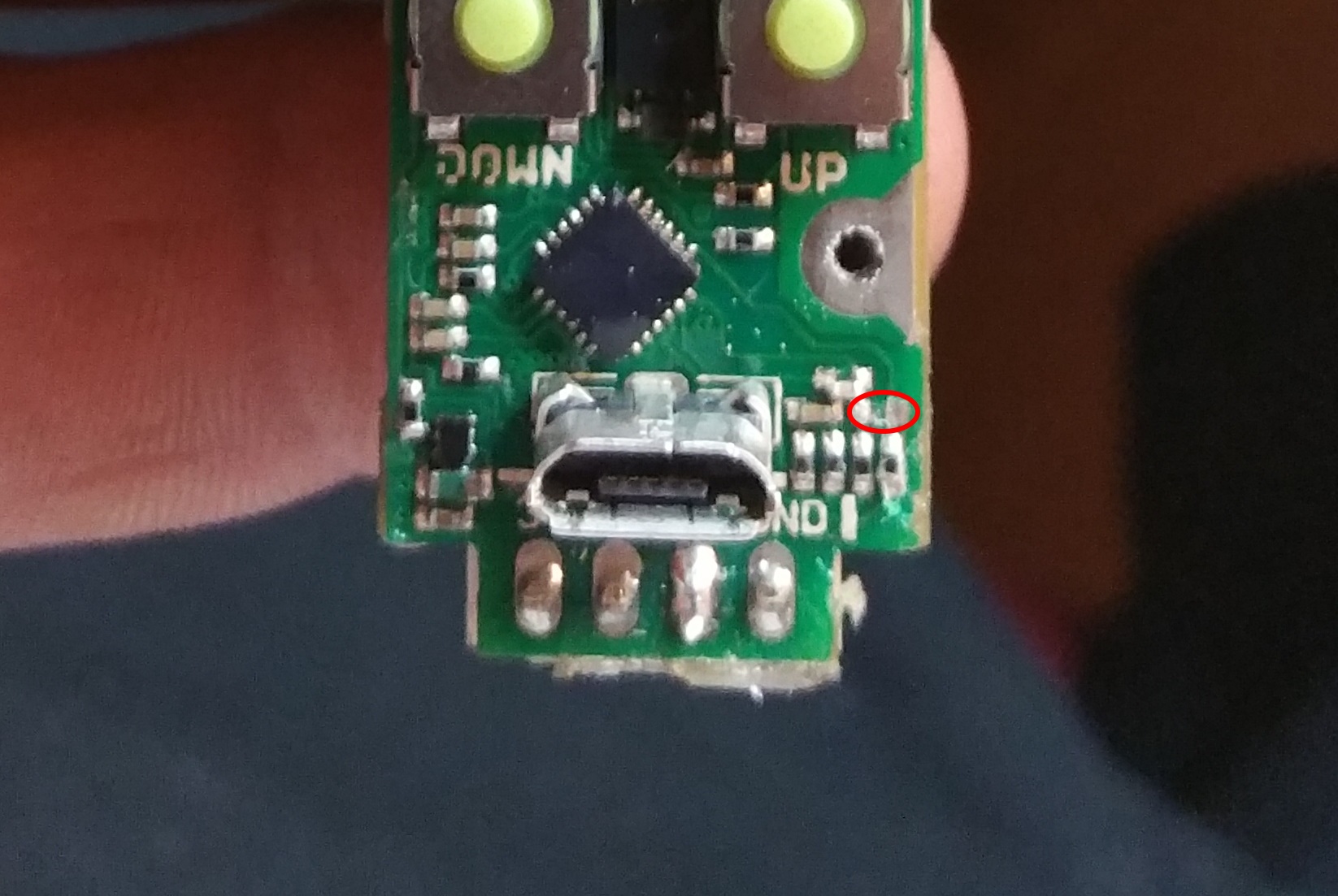

Yurlosin Posted July 23, 2015 Author Report Posted July 23, 2015 it has the newest firmware porblem is getting worse last night it read all 3 cells now it is not reading cell1 at all so it will not power up on its own only thing i did was leave it connected to the charger all night i have tried swapping the battery to another board that works fine no luck there maybe a bad trace in the board?
Yurlosin Posted July 23, 2015 Author Report Posted July 23, 2015 Let me know if you need any closer pics
John Posted July 24, 2015 Report Posted July 24, 2015 Yep. If you look in the upper right corner, there are components that got knocked off. PM me your address and I'll swap you for another.
Yurlosin Posted August 2, 2015 Author Report Posted August 2, 2015 John this is the first board I mentioned in the other post
Protocol-X Posted September 25, 2015 Report Posted September 25, 2015 Could you point it where they are missing? I have the same issue and tried everything.
