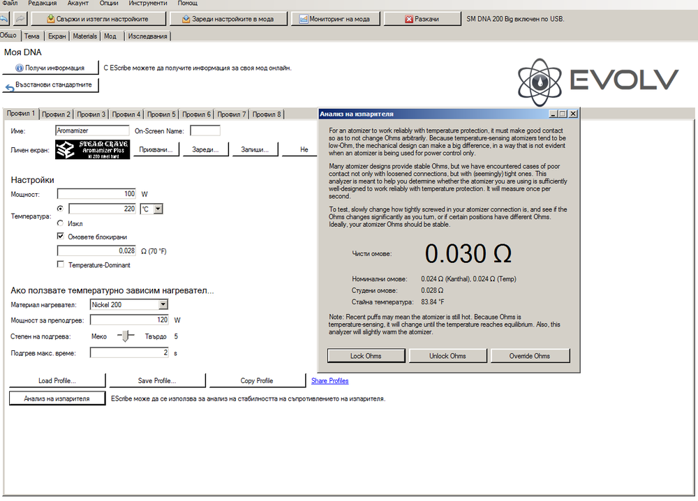

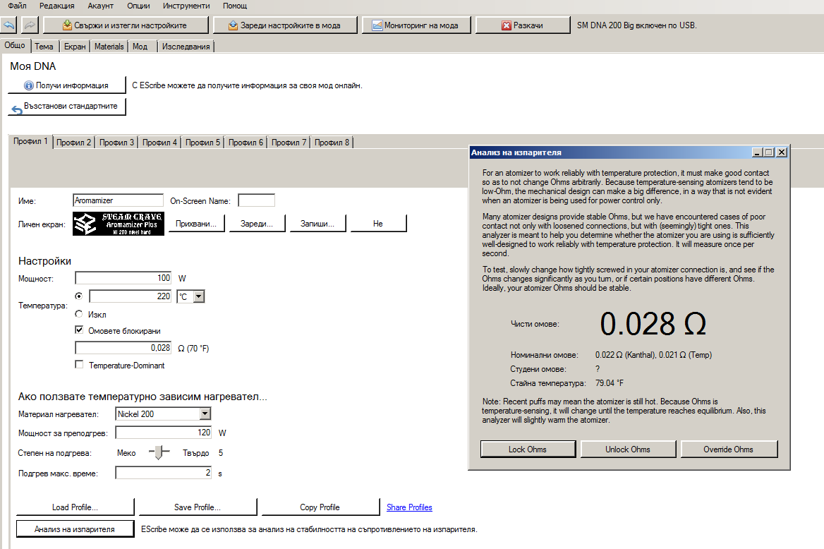

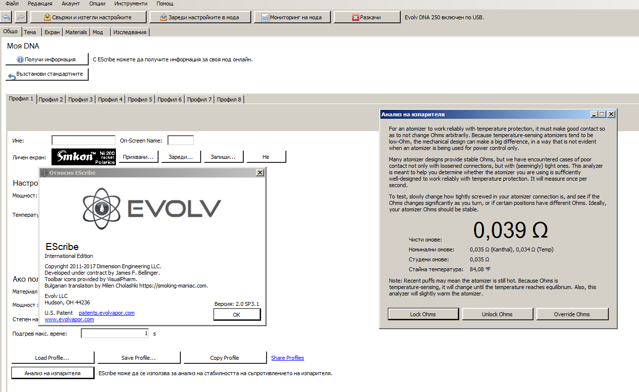

copyman Posted May 16, 2017 Author Report Posted May 16, 2017 The translation for Escribe 2.0 is made. I use the case to request: the text of the "atomizer analysis window" is not included for translation. If it can also be included in the translation file, because here is very important information about pure understanding of cold ohm, nominal ohm ... Please ... Milen EScribe.po.zip 1
James Posted May 16, 2017 Report Posted May 16, 2017 Hello @copyman! Here are the strings: msgid "For an atomizer to work reliably with temperature protection, it must make good contact so as to not change Ohms arbitrarily. Because temperature-sensing atomizers tend to be low-Ohm, the mechanical design can make a big difference, in a way that is not evident when an atomizer is being used for power control only." msgstr "translation" msgid "Many atomizer designs provide stable Ohms, but we have encountered cases of poor contact not only with loosened connections, but with (seemingly) tight ones. This analyzer is meant to help you determine whether the atomizer you are using is sufficiently well-designed to work reliably with temperature protection. It will measure once per second." msgstr "translation" msgid "To test, slowly change how tightly screwed in your atomizer connection is, and see if the Ohms changes significantly as you turn, or if certain positions have different Ohms. Ideally, your atomizer Ohms should be stable." msgstr "translation" msgid "Note: Recent puffs may mean the atomizer is still hot. Because Ohms is temperature-sensing, it will change until the temperature reaches equilibrium. Also, this analyzer will slightly warm the atomizer." msgstr "translation" Thank you! James

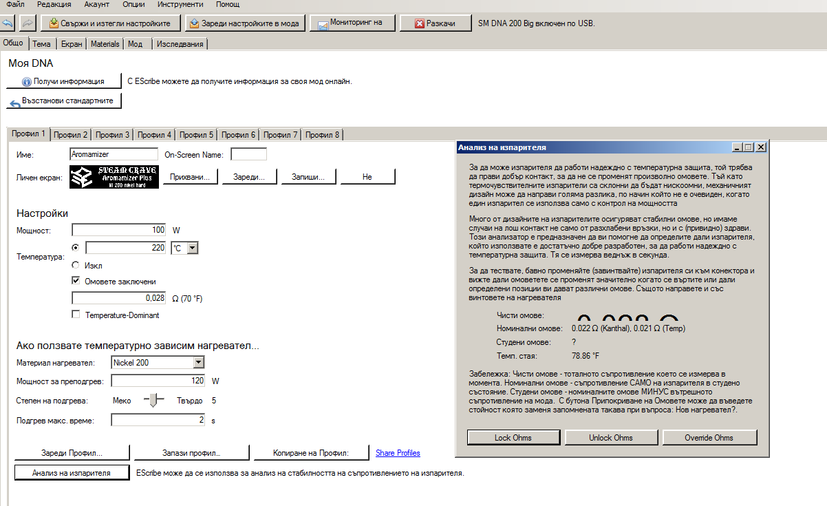

copyman Posted May 19, 2017 Author Report Posted May 19, 2017 Hello, I'm sorry James but the translation is done and the messages in the window do not change - they are still in English .. Here's the added translation: Best Regards Milen EScribe.po
James Posted May 19, 2017 Report Posted May 19, 2017 There must not be an extra line between msgid and msgstr. Also, all quotes must be "
copyman Posted May 20, 2017 Author Report Posted May 20, 2017 I'm sorry for my pass, but after the changes the translation is not displayed again ... EScribe.po
James Posted May 20, 2017 Report Posted May 20, 2017 Here's your .po file with quotes corrected. (The right-side quotes were the wrong kind.) It translates. The Atomizer Analyzer dialog does not seem to be resizing, though. That's a bug I'll need to fix. EScribe-QuotesFixed.po
copyman Posted May 20, 2017 Author Report Posted May 20, 2017 Hello James, Interesting ... in EScribe 2.0, the new strings are visible in Bulgarian, however, after update in EScribe 2.0 SP1 are in English

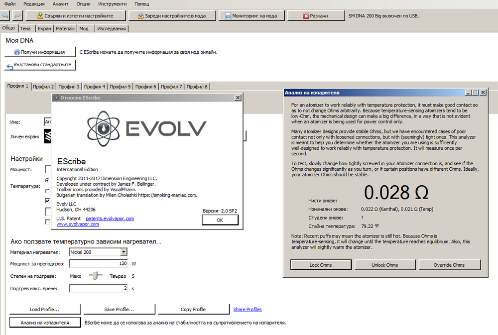

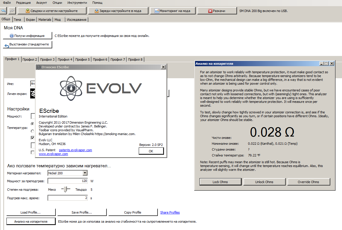

James Posted May 23, 2017 Report Posted May 23, 2017 Hi @copyman. I posted EScribe 2.0 SP2. It should resize correctly with translated text, and also I have included the msgid, etc. in the en.po file. Hopefully it works
copyman Posted May 28, 2017 Author Report Posted May 28, 2017 (edited) I'm sorry James - no change with the new service pack. Do not worry - there are important things to fix - inscriptions are not the most important. Here it's Escribe 2.0, Escribe 2.0 SP1, Escribe 2.0 SP2 ... Best Regards Milen Edited May 28, 2017 by copyman

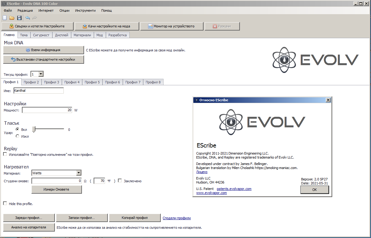

copyman Posted August 4, 2021 Author Report Posted August 4, 2021 Translation of the latest Escribe - 2.0 SP27 INTL for Windows bg.po.zip

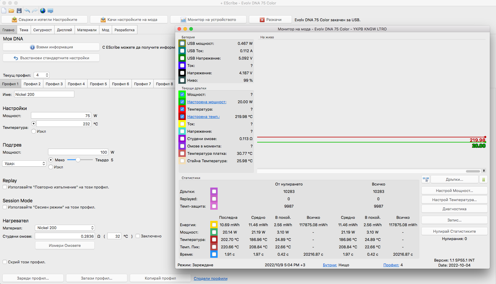

copyman Posted October 9, 2022 Author Report Posted October 9, 2022 Translation of the latest Escribe - 2.0 SP45 INT bg.po.zip
