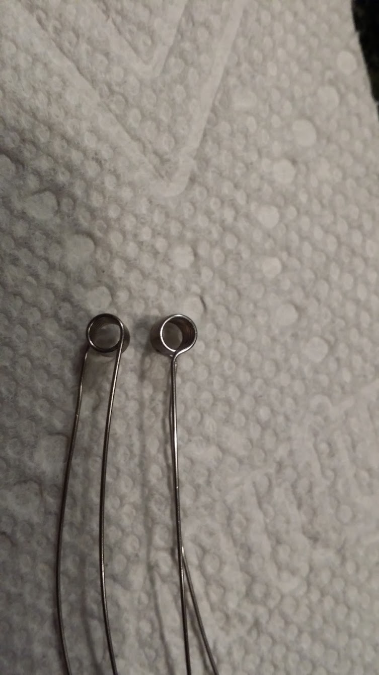

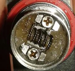

BUILD: Dual coils, Titanium 28 gauge, 5.5 wraps, 2.5mm ID. Fairly wide coil spread. According to steam engine total resistance should be .20 ohms. The mod shows .27 ohms. I assume it's the long leads needed to get to the posts. I'm a pretty novice builder, most of them on simple Subtank Minis, the coils use very short leads, and it's an easy build using mostly 24 gauge Ti, 5-6 wraps. So I have NO idea how folks deal with really long leads that don't sit in the cotton, are mostly out in the open and can get HOT? I've seen photos of builds like mine, so I'm not sure what the difference may be. But certainly turning OFF the preheat settings, has helped. Ideas welcome!
I find Sweet Spot (Titanium alloy, it's not pure Ti) you can get red hot leads especially if they're >3 mm in length. Also most of the polished Titanium lost ~1 gauge from being polished.
A 5.5 suggests 6 out and 5 in as a 'U' shape .. try making the coil a pure 6 warp with 90-degree bends (quick and dirty example):
Hot legs from Sweet Spot Titanium (alloy of TiFe; note grade 1-5):

coil2.jpg [/QUOTE] I'm using G1 titanium from Unkaman in these builds. My coils are not wide enough to make the post holes. So even with a turn as you show, I have to go out left and right with bare wire leads to make it to the posts, hope I'm explaining it well.
IF your Titanium 'Grade 1' is doing that then I'd really question it being 'Grade 1' .. ?? So if it's a problem then more coils spaced like a spring, leads bent as described and have the spring coil from on post to the other. Ideally, I prefer 24 Gauge Titan Wires Titanium .. it works flawlessly.

I like 24 gauge better myself, but to get the property build in this base, I had to go with 28. I can't spread the coils any further, they are already far apart.
Then I'd get some 26 gauge. I use Titan Wires and it's been a pleasure to use. Their polished is off by 1 gauge; so 26 = 27, 24 = 25 and 22 = 23. I have yet to find any Atty that I can't get 24 gauge to work.
