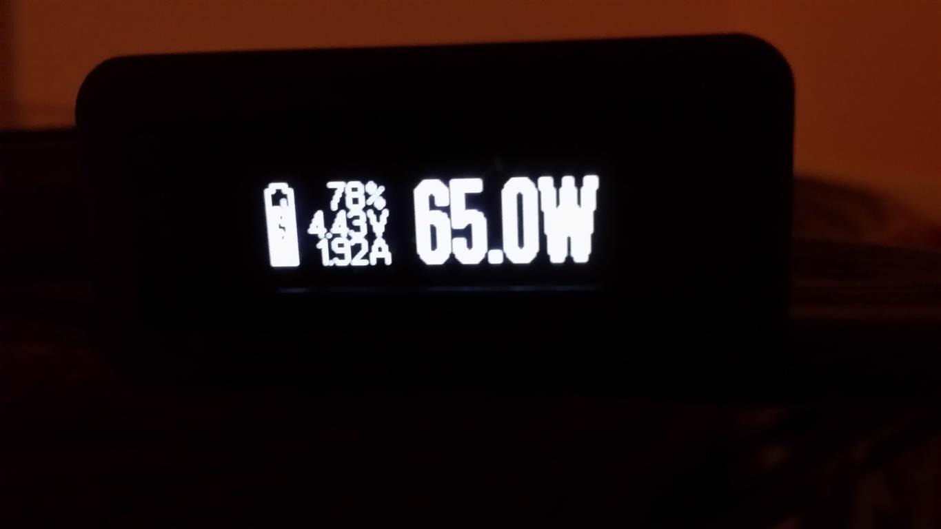

Jaquith Posted December 2, 2015 Report Posted December 2, 2015 The standard DNA 200 draws 1A @ 5V or less whether it's connected to a 2.5A USB supply. However, there are modded boards like those used in the Vapor Shark DNA 200 that can draw up to 2A @ 5V. The idea is no different than a 40W bulb drawing 40W from a plug capable of a much larger supply of power. The PC's are moving towards USB 3.1 with a backwards compatibility with its 100W supply capacity. So a DNA 200, typical, should not exceed 1A, but as I mentioned there are exceptions.Charging, a 2A charges 400% (4 times) faster than a 0.5A 'typical PC supply' and 200% (2 times) faster than a 1A supply.Vapor Shark DNA 200 (2A)
