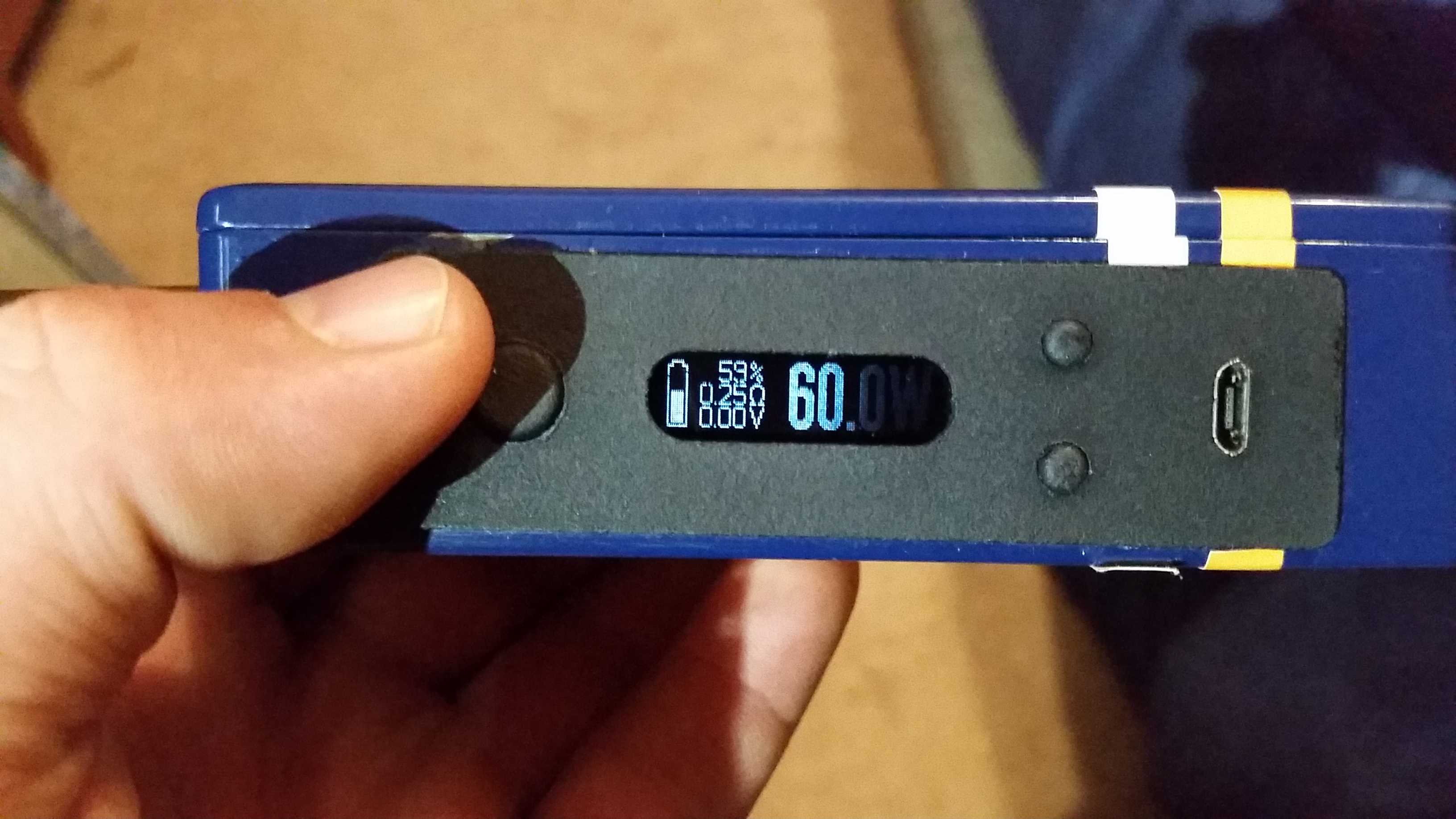

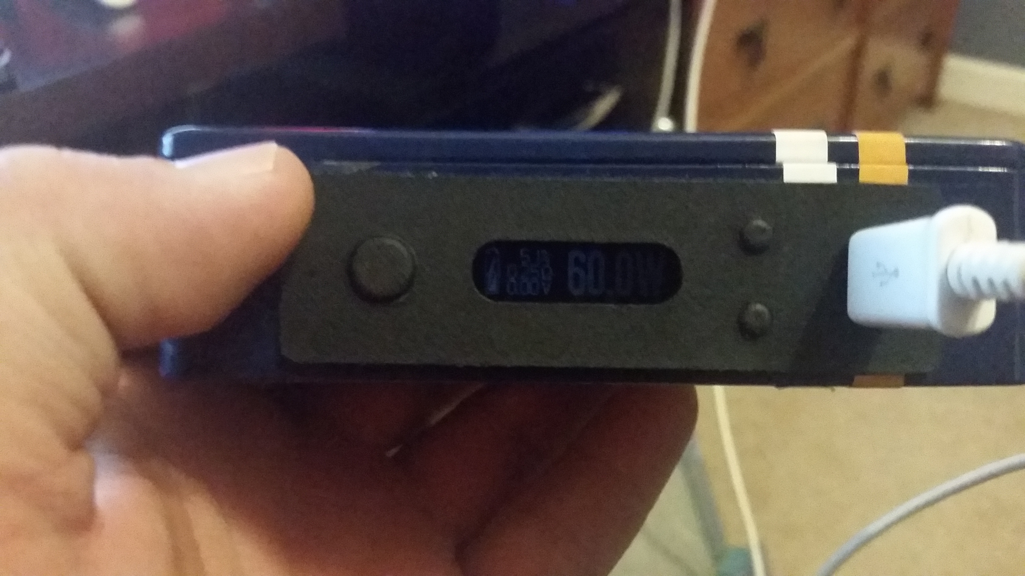

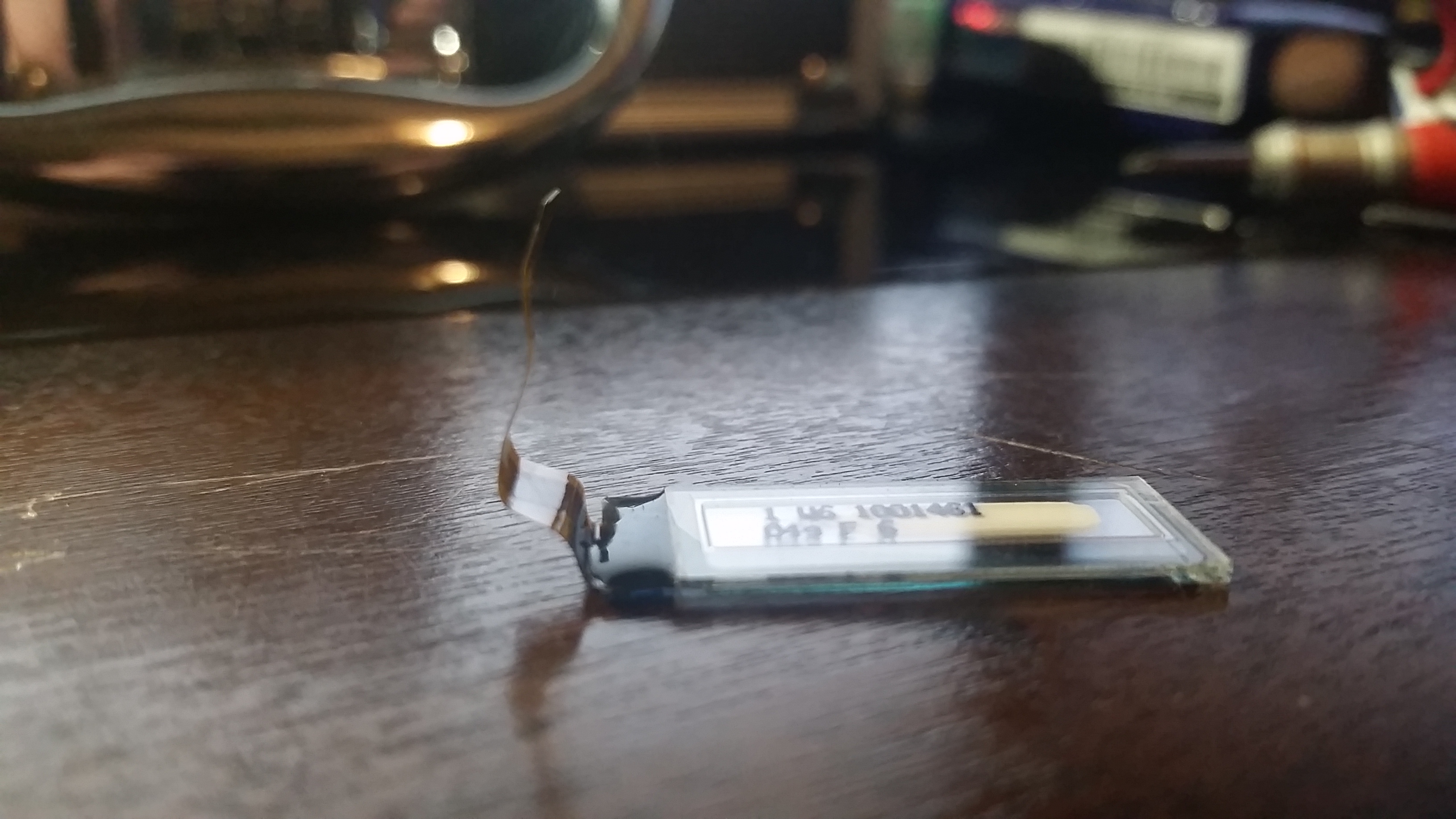

kungpow Posted November 17, 2015 Author Report Posted November 17, 2015 So I went to VCC this past weekend. Brought along my DNA 200 mod and at the beginning of the weekend (Friday) I noticed the screen started to dim on the right side. It got worse as time went on. The first pic is from Sunday night when I got home and the second was taken right now. I've reseated the screen a few times and that hasn't fixed it. The mod itself wasn't dropped and spent most of the weekend in my backpack (locked of course) anyone seen this before? Or am I out another screen? I also included a pic of the screen ribbon cable. It doesn't appear to be pinched very hard and it is not mounted over the fire switch. I've already made that mistake.
tehdarkaura Posted November 17, 2015 Report Posted November 17, 2015 My guess is there is a crack that isn't easily visible -- You should have something protecting the screen (I've used a cut down cd case and that works well.) Chances are something (in your bag?) pressed on the screen and cracked it.These screens are very hard to come by right now -- so protecting it is a very good idea.

Spector NS5 RD Posted January 4, 2016 Report Posted January 4, 2016 the solution is a new screen. i've had a few oleds' do that to me. hard to say what causes it. i can say when the matrix is exposed to oxygen, that's when the screen starts to die. usually creeping from one side to the next, until the entire screen goes black. you gotta think out of all the oleds made there are going to be a few that fail. we just don't want one of them to be owned by us.
subvaperjim Posted January 4, 2016 Report Posted January 4, 2016 Hi a quick follow up to my post last night. My screen had done the exact same thing, this morning however it is compleatly black and there is an obvious crack that couldn't be seen while it was partially working. So new screen and put this one down to pilot error in my case
