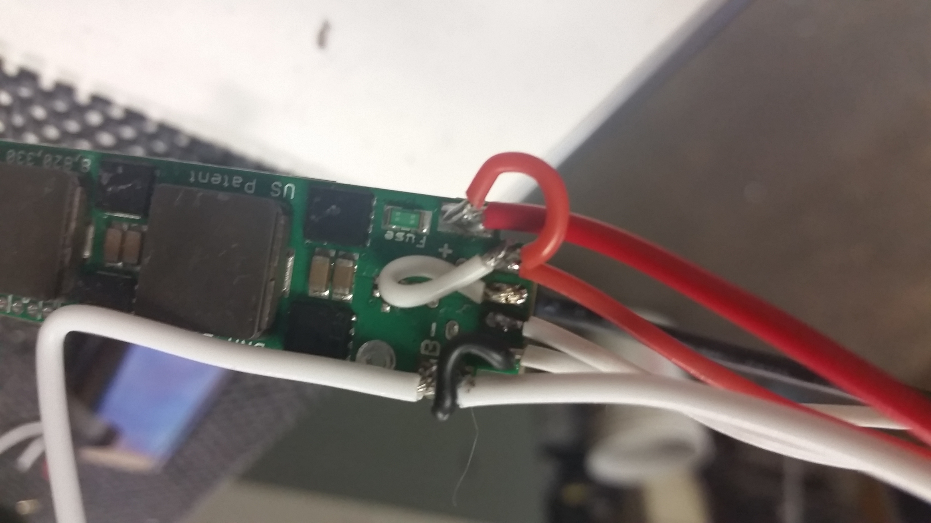

Thatguy Posted May 5, 2016 Author Report Share Posted May 5, 2016 can smeone please tell me the correct way to wire up the balance blug for a 2s lipo. I found a bunch of ways not to do it, if anyone knows the right way i would love to know.thanks, Link to comment Share on other sites More sharing options...
dwcraig1 Posted May 5, 2016 Report Share Posted May 5, 2016 Same for 2S Lipohttps://forum.evolvapor.com/topic/66226-topic/?do=findComment&comment=895167 Link to comment Share on other sites More sharing options...
Thatguy Posted May 6, 2016 Author Report Share Posted May 6, 2016 Thanks bro! This is why I did and it's working, showing voltage for each cell, that's what I want,I feel like I jumped an extra set of wires? Link to comment Share on other sites More sharing options...
dwcraig1 Posted May 6, 2016 Report Share Posted May 6, 2016 I think that the short black and short red wire could have been omitted but I'm just guessing.I believe that + an - on the balance taps are connected internally on the board to battery +and -. Link to comment Share on other sites More sharing options...
Thatguy Posted May 6, 2016 Author Report Share Posted May 6, 2016 i tried it without them and it didint work at all but I put them both on at the same time and it works correctcly so I dont knkow if they are both needed or just one side is, but whatever it works now.. protptype 200 squonker is on deck! Link to comment Share on other sites More sharing options...
dwcraig1 Posted May 6, 2016 Report Share Posted May 6, 2016 I was only guessing on that, great that it's working for you.Edit: So I studied the diagram some more and can't see how it wouldn't work......but I believe you. Link to comment Share on other sites More sharing options...
Thatguy Posted May 6, 2016 Author Report Share Posted May 6, 2016 I appreciate the help bud. Tag before I added those jumpers it only turned the screen on when I held the fire button down but it wouldn't do anything but say dna200 Link to comment Share on other sites More sharing options...
