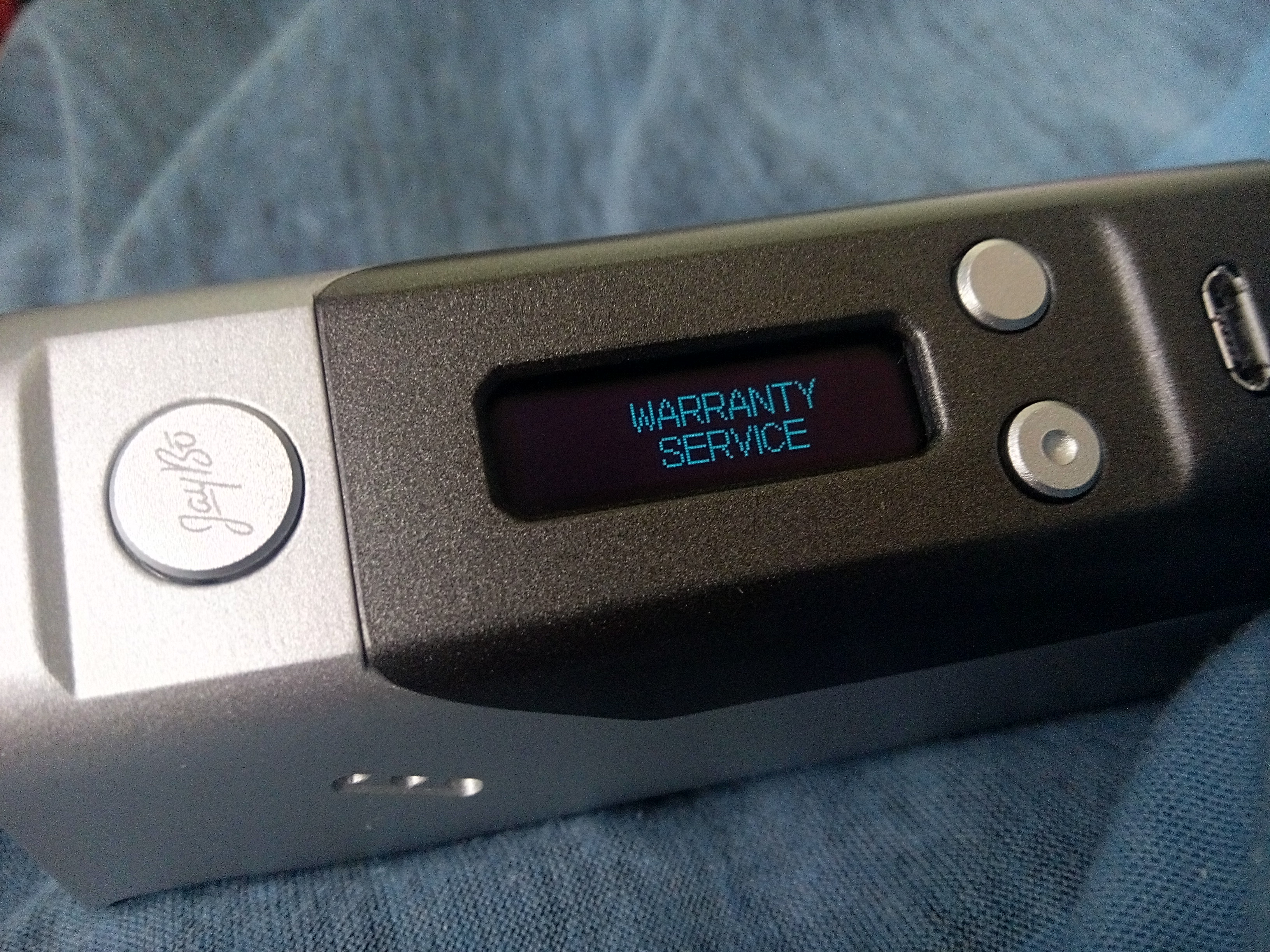

hybsa03771 Posted May 12, 2016 Author Report Posted May 12, 2016 Hello guys i just want to clear the things here. I have my WiSMEC DNA 200 blue screen edition and i just bought it last week from a reseller. I checked the serial and my mod is manufactured last january 27 2016. I don't know if this is an issue or what? I am getting a "Warranty Service" message when i press the power button with 2pcs 18650 batteries, but works fine with 3. It is also giving me the message when i take out 1 of 3 batteries while the screen is on. Anyone having the same issue or is it normal? Thanks guys!
hybsa03771 Posted May 12, 2016 Author Report Posted May 12, 2016 hello thank you for your reply sir, btw so is it normal that if I use my wismec using 2 batteries then the message "warranty service" will appear? and also does firing my wismec using 2 batteries can damage my mod or some wirings inside my mod? because I accidentally pressed the fire button. im sorry for that, thanks
BillW50 Posted May 12, 2016 Report Posted May 12, 2016 soulvape said:IT only works with 3x 18650Unless you use a shorted dummy cell for cell 3 (back right) and configure it with EScribe for a 2 cell operation. I used a 2 1/2 inch bolt in mine to see if it really works (133 watts max). It does and then I switched it back to 3 cell operation again.
Scarab Posted May 14, 2016 Report Posted May 14, 2016 Never saw this message. I try operate mod with 2 batteries (w/o dummy cell). It just won't work w/o any messages. Board manufactured january 29 2016.
BillW50 Posted May 14, 2016 Report Posted May 14, 2016 Yes that is what happens with less than 3 batteries. It will work with two batteries (133 watts max), but you must use a dummy cell for the third cell (back right). And configure EScribe to use two cells and then upload it to your mod.
Scarab Posted May 14, 2016 Report Posted May 14, 2016 I know about dummy cell and EScribe configuration. I just doing exactly like TC said and don't saw any "Warranty Service" message.
BillW50 Posted May 14, 2016 Report Posted May 14, 2016 Nope mine doesn't either on my four DNA200. But it wouldn't surprise me that some do. Could be firmware dependent too.
