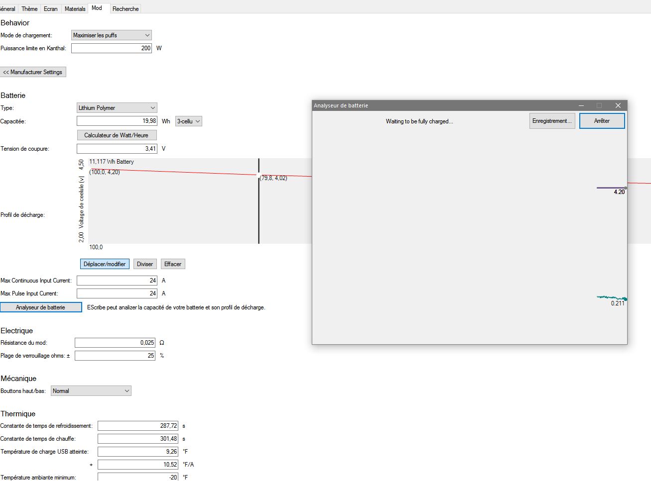

detekt Posted June 21, 2016 Author Report Posted June 21, 2016 Hello to everyone , I want to say first , sorry for my English , is not my maternal language ..just to ask ,(after many search I don't find the solution yet) I try to find the right setup in Escribes about the battery , in below my screenshot of my escribes actually , on Escribes , is fully charged , but on my box is 3/4 plain, when I launch the monitor system for check the analyser battery , is write 15.43(Nvm now I launch again the monitor system is write 19.967 W/h .. lol ) bug ?in your opinion this is the right setup in below for my battery ?1800*11.1/1000 = 19.98 Wh/h Thx a lot for your help

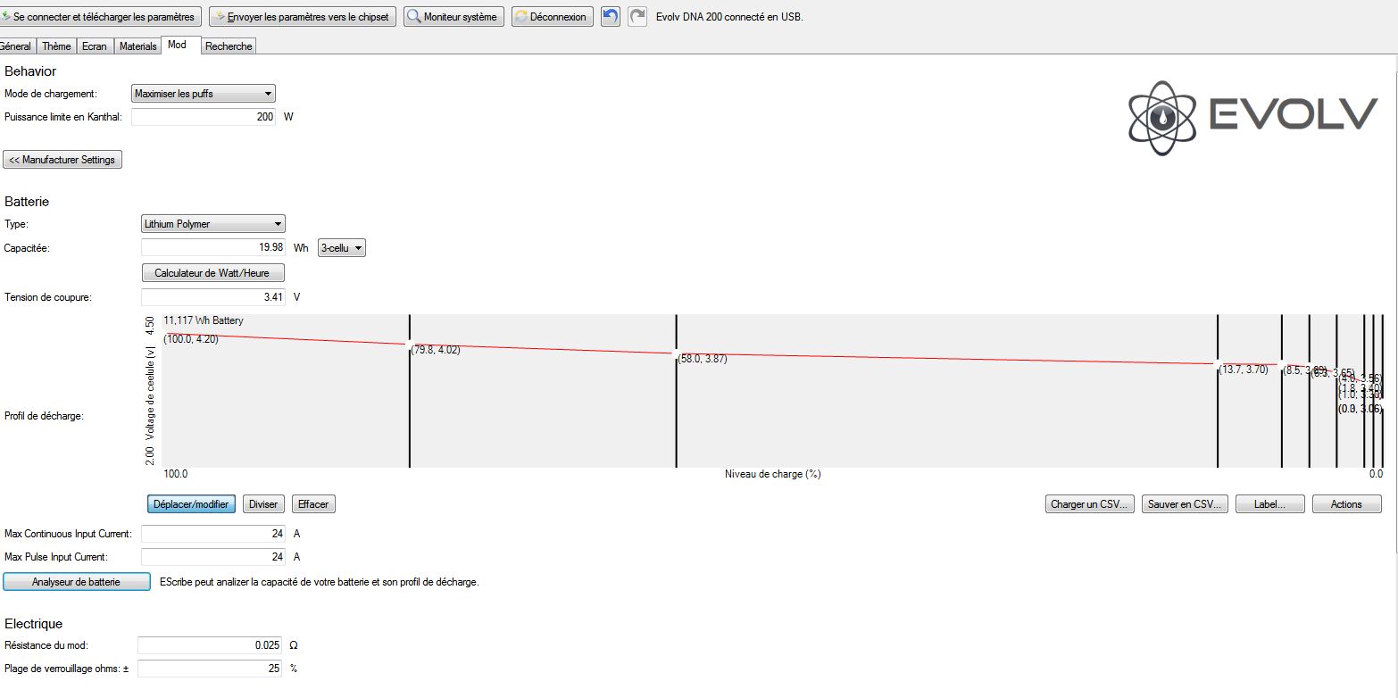

dwcraig1 Posted June 21, 2016 Report Posted June 21, 2016 The Lion Power battery while labeled 1800 mah is closer to 1250 - 1300 mah. Use 1400 - 14.43 watt hours for the setting.As far as the changing numbers, I don't know.
detekt Posted June 21, 2016 Author Report Posted June 21, 2016 is strange , he sold a battery 1800 Mah , and he give approximately 1200 ~1400 ?
dwcraig1 Posted June 21, 2016 Report Posted June 21, 2016 It is pretty widely known that the capacity of this particular battery was overstated.
detekt Posted June 21, 2016 Author Report Posted June 21, 2016 Ok , if I follow your plan , what risk i have if the capacity stay like my picture ?
dwcraig1 Posted June 21, 2016 Report Posted June 21, 2016 Only your battery % display or battery symbol will not be accurate.I guess it came in a Vapecige mod correct?
dwcraig1 Posted June 21, 2016 Report Posted June 21, 2016 You might want to run the battery analyzer if your after good accuracy with the battery gauge.
detekt Posted June 21, 2016 Author Report Posted June 21, 2016 i will try now , i wait the full charge and test the battery analyler , i will keep post when i have the result ;-)
detekt Posted June 21, 2016 Author Report Posted June 21, 2016 Well , when i use the battery analyzer he ask always to wait to the full charge , but is still full charged .. any chance to help ?
dwcraig1 Posted June 21, 2016 Report Posted June 21, 2016 It has to be fully charged to start battery analyzer. Case analyzer needs to have the battery on the low side. It should eventually start
Spirometry Posted June 21, 2016 Report Posted June 21, 2016 Wait it out. You can see on the graph that the charge current was falling.
detekt Posted June 22, 2016 Author Report Posted June 22, 2016 All was done yesterday , I miss a bit time to write here sorry So , the right W/h now is 14.43 you are right on your first reply DwCraig1 Thx for your help
