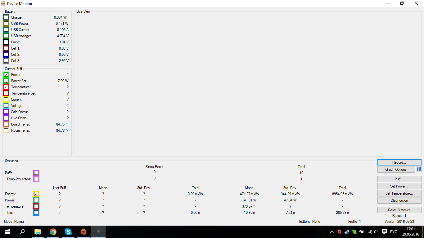

Nuvon Posted June 29, 2016 Author Report Posted June 29, 2016 Today i got my smy sdna 200 and when I turn on device it showed me "warranty service" and after ~4.5 hours charging it shows "Check battery"p.s I tried to perform usb recovery charging , but it doesn't help me
BillW50 Posted June 29, 2016 Report Posted June 29, 2016 You just received it? Oh that isn't good. EScribe's Device Monitor is saying cells 1 & 2 are totally dead. If you can, I would return it to the place you got it. As I am not buying that the two cells are shot (but they could be). But anything left to do requires opening it up and voiding the warranty.
BillW50 Posted June 29, 2016 Report Posted June 29, 2016 Oh I should add that you should decide something soon. As if it isn't too late yet, you have no longer than two days to remove the battery or those two cells I predict will be totally shot (and non-recoverable). As I believe when it reads a cell at or near zero, it probably isn't true. But whatever went wrong, it does drain the ones that reads 0. And one of mine did that and it had taken a full cell 4.20v to 3.0v in two days. Say by the way, do you have a multimeter by chance?
