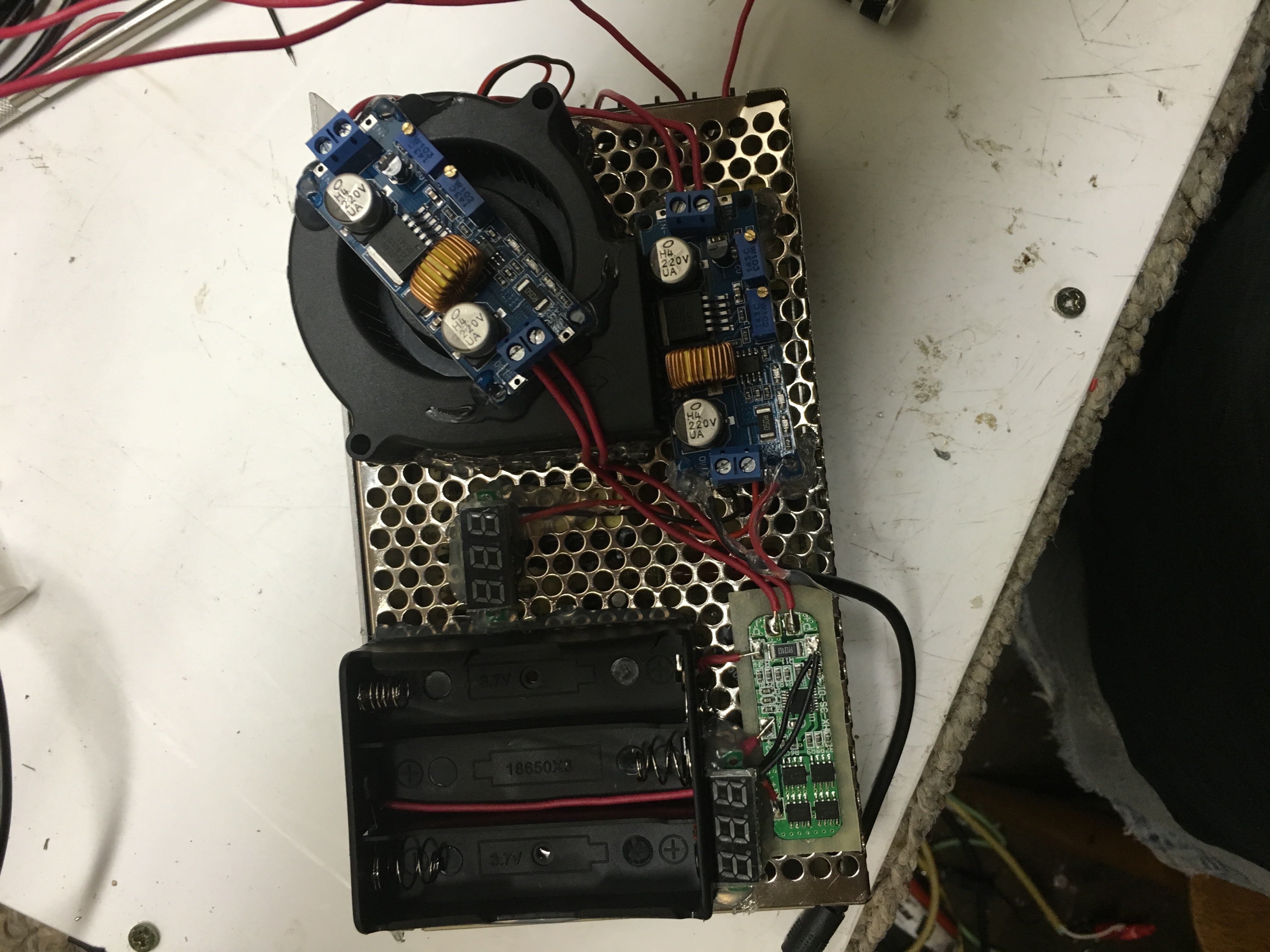

So as I was running more tests I ended up frying one of my CV/CC boards it was set at 4amps. Good thing I bought 5 of them. But any ways I built a charging station with a blower fan for the 18650's and the lipo pack. The VTC4 charge time was an hour at 2.5amps and the lipo pack (2.2Ah) was 35 mins at 5amps. These CV/CC boards get really warm at a setting of 2.5amps with no heat sink or air flow. The 5.5mm male jack got warm but not hot enough to melt the insulation so I'm leaving it where it's at, I'm at the limit of it being somewhat safe. So much for trying for 6A
