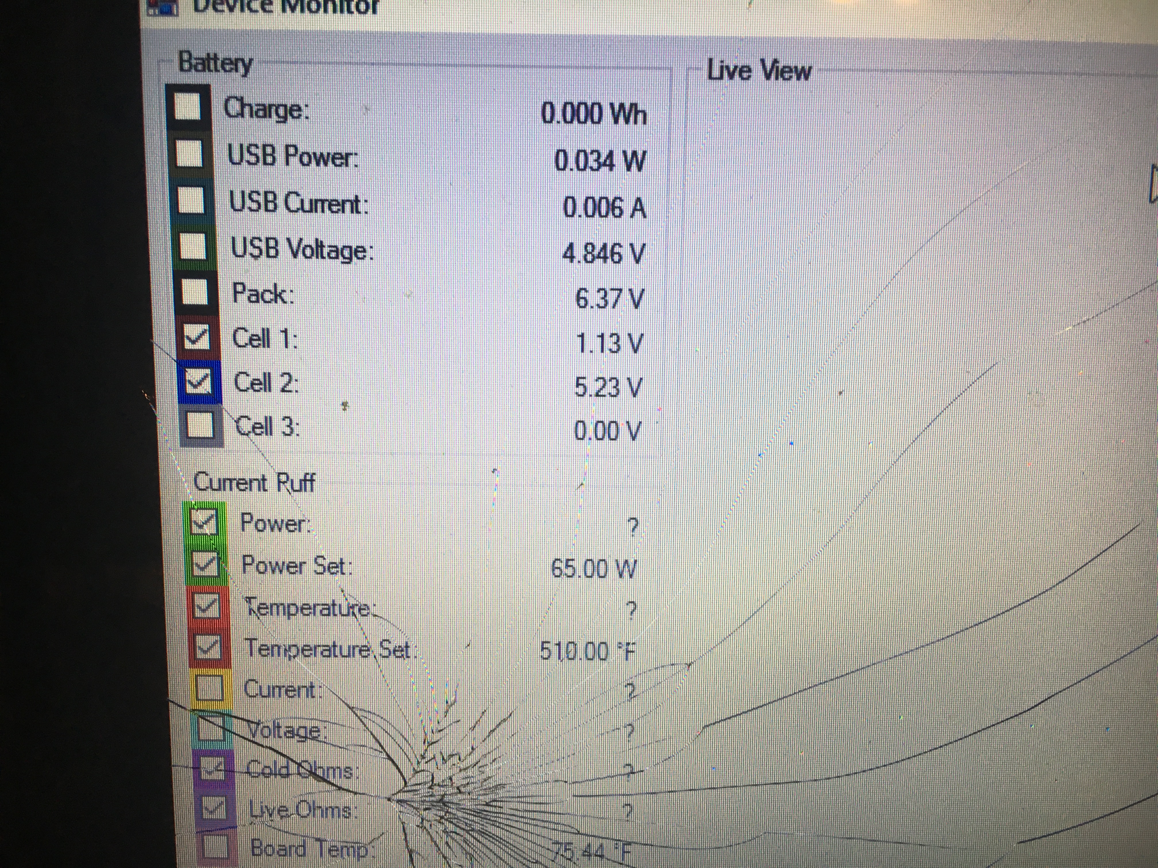

jdemp Posted July 17, 2016 Author Report Share Posted July 17, 2016 With freshly charged batteries when the fire button is pressed, it says check battery. With the mod connect to charging source it stays on and say the same when you press the fire button. With it not connected it will not stay on and you have to hold the fire button for it to come on. as soon as you let on the button it goes off. In device monitor battery cell 1 is reading 1.13 and cell 2 is reading 5.22. I have tried hard and soft reboot, USB recovery and nothing is happening.Please help. Link to comment Share on other sites More sharing options...

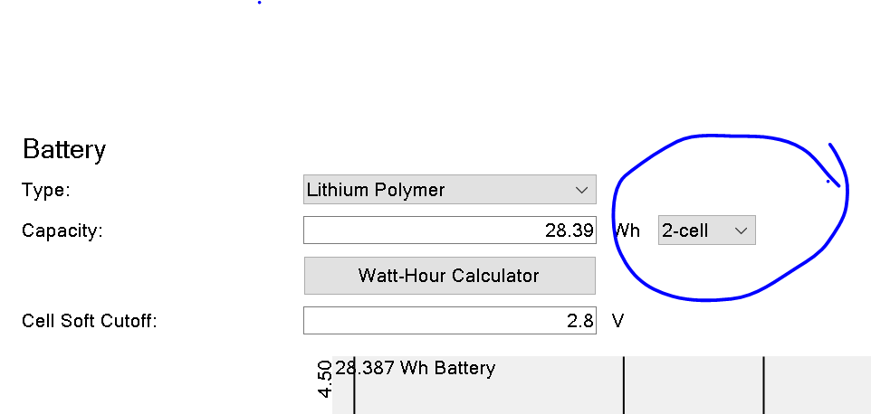

Spector NS5 RD Posted July 17, 2016 Report Share Posted July 17, 2016 jdemp said: With freshly charged batteries when the fire button is pressed, it says check battery. With the mod connect to charging source it stays on and say the same when you press the fire button. With it not connected it will not stay on and you have to hold the fire button for it to come on. as soon as you let on the button it goes off. In device monitor battery cell 1 is reading 1.13 and cell 2 is reading 5.22. I have tried hard and soft reboot, USB recovery and nothing is happening.Please help. Expand if you go into escribe and click on "manufacturers settings", are your battery settings at "2 cell" ? Link to comment Share on other sites More sharing options...
jdemp Posted July 17, 2016 Author Report Share Posted July 17, 2016 yes they are. Link to comment Share on other sites More sharing options...
Spector NS5 RD Posted July 17, 2016 Report Share Posted July 17, 2016 jdemp said: yes they are. Expand did the device ever work/vape? can you post a screen shot of device monitor with cell 1-3, pack voltage, and usb current checked. cell 1 voltage worries me. also make sure both your batts are fully charged and at the same voltage.honestly i'm thinking this might be a board issue which means a RMA situation. but let's try some things first..who knows, you might get it working. Link to comment Share on other sites More sharing options...
jdemp Posted July 17, 2016 Author Report Share Posted July 17, 2016 Both batteries are fully charged to 4.2. This is what device monitor is saying. Yes I've had the mod for about 2 weeks and has worked flawlessly up until today. I haven't dropped it or anything. That's what has stumped me on this. Link to comment Share on other sites More sharing options...

Spector NS5 RD Posted July 17, 2016 Report Share Posted July 17, 2016 if you're confident in your vendor honoring the warranty i'd say contact them first before opening up your mod. if not, then open her up and take a close look around the balance tap area for any eliquid or metal shavings, like my boy dwcraig1 asked about. also check for burnt or any board components that may have fallen off. my guess is the analog font end went out (square black chip above usb port on circuit board) or even a small capacitor or resistor got knocked off or fried itself and you need a new board, but i could be wrong. Link to comment Share on other sites More sharing options...
