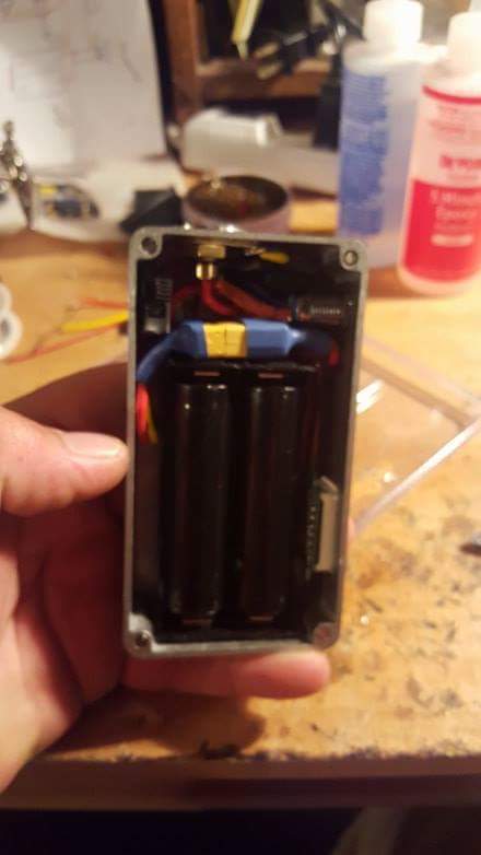

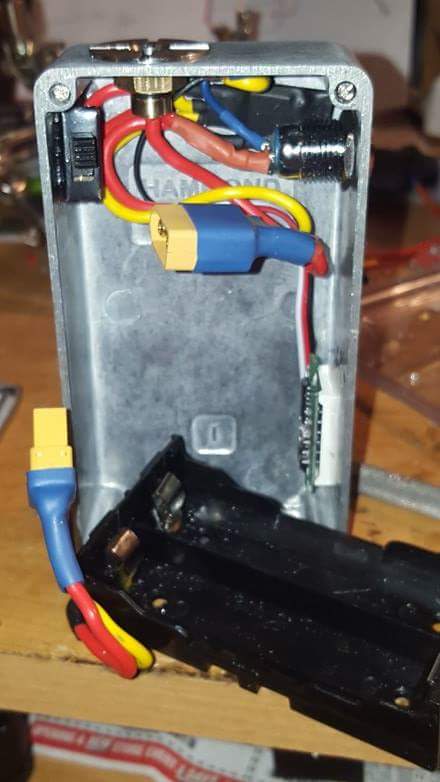

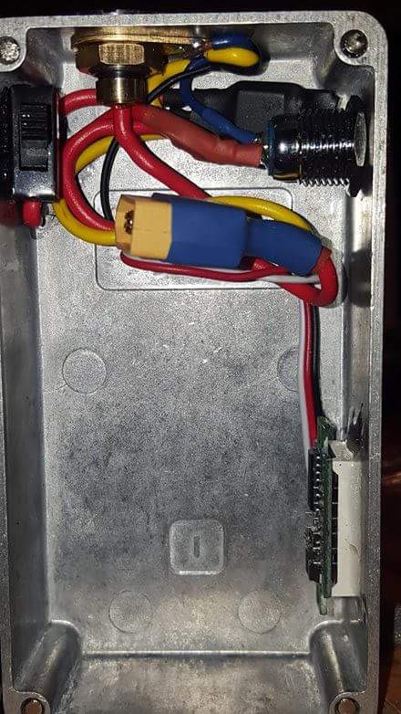

Guest Posted July 27, 2016 Report Posted July 27, 2016 I am currently buying a box but want to make sure it is safe. I didnt know who else to ask without insulting the builder. It is an unregulated lipo no pwm its what i asked for. But he used 18guage stranded wire with a 5amp anti vandal momentary switch, with a 330 ohm risister for the led in the switch. And an xt60 deans connector. Does this box sound safe i will be using a 11.1 volt 3s lipo and be building a a .4 that will push 12 volts it does have a mosfet. He said that the switch could handle 20 volts.
Spector NS5 RD Posted July 27, 2016 Report Posted July 27, 2016 welcome to forum justinenlow. hard to say. depends on the mosfet he used. if it's amp rating is hefty, then ya. he used 18 gauge for the 510 wiring as well? that could be a little thicker. however, you don't need thick wire to just switch the mosfet on tho (switch to mosfet wiring). kind of hard to say by looking at a picture if someone's works is safe or not.
